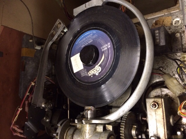

Hey everyone!
I've been working on this rockola 480 for a friend. When I got it the gears were stuck so I took out the gripper assembly, cleaned the dried up grease and applied some 30 weight oil to it. I reassembled and now it will grab the record, bring over to the turn table, set it down but then the inner gripper piece goes out too far which causes the record not to spin. I attached a picture of what is going on. I'm sure it's an adjustment of some sort but I can't find anything in the manual that points in the right direction. I also have been checking the forum but couldn't find anything like my problem.
If anyone can't point me in the right direction I would appreciate it.
Thank you in advance and thanks for setting up this site to help those with jukebox problems.
Brad

Hi Brad,
Is that inner section going to far, OR, not going far enough--it should "retreat",
upon setting record down. Ron Rich

Hey Ron! Thanks for the response.
The gripper sets the record down, the inner piece retreats and then it pops back out towards the record causing it to stop.
If I use the lever (operate/off/scan) and turn to off right when it sets the record down then that piece doesn't pop back out. I can then slide it back to operate and no problems...

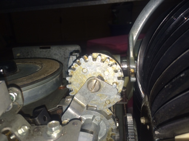

I'm back again. Thanks again for everyone's time helping me attempt to get this thing figured out.
I took the gripper assembly out to get a better idea on the gear timing.
The picture attached shows the gear position in the play mode. It looks like the outer gear(one closest to you) is what pops that piece in and out which causes it to stop the record. The piece (attached to gear with screw) that connects to the tone arm linkage is what is causing that gear to move clockwise if it pushes down on that pin sticking out...that piece is pretty loose.
Once it goes down and hits that pin the gear moves, pops out the inner piece towards the record and causing a jam.
Please let me know what your thoughts are. Gears out of alignment? Should I take apart and try to find correct reassemble of gears (haven't seen that online yet and it's not in manual).
Thanks again everyone!

by Rob-NYC » Sat Jun 06, 2015 6:59 am
Brad, did you check the sequence of the microswitches near the tonearm? If you removed the gripper assembly what did you remove? There is a cam that actuates those switches and if disturbed it must be retimed. If the switches were disconnected, then connections must be checked. I think this is just as I wrote previously, a timing problem.
If this machine was bought as-is non-working some additional tinkering with the microswitches and their cam may have occurred.

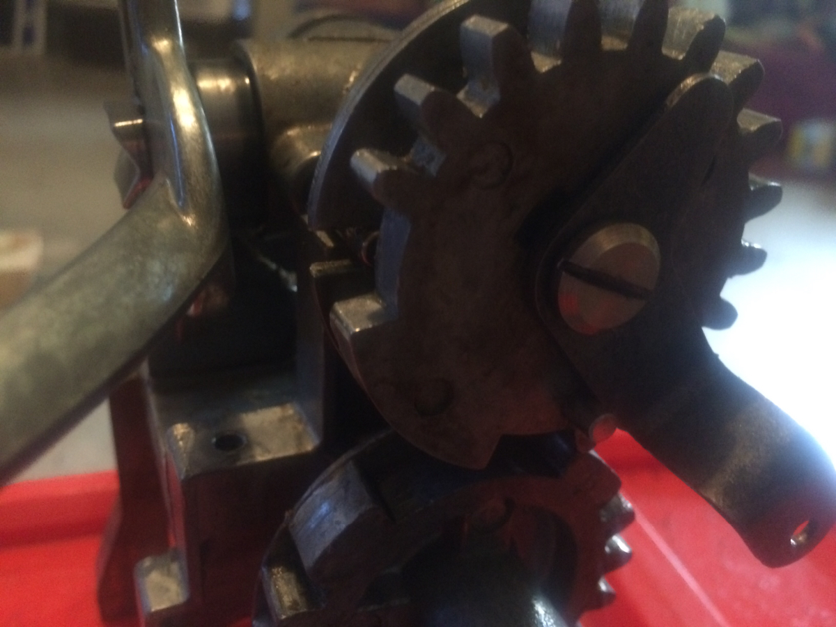

Hey guys! I had to take a break from the jukebox but I'm back on it. Thanks again everyone for your help.
Rob-I unscrewed the microswitches but didn't take the connections off. In the manual it says to make sure the #1 microswitch is in the groove in the home position. I've done that and have adjusted many times in that groove to see if anything changes. No dice.
I have attached a picture of the gears in the home position. To me it seems off one tooth that should go clockwise. I'm hoping someone might be able to tell me if these look right or not.
Thanks again everyone for your time. I really appreciate it. You all are great!
