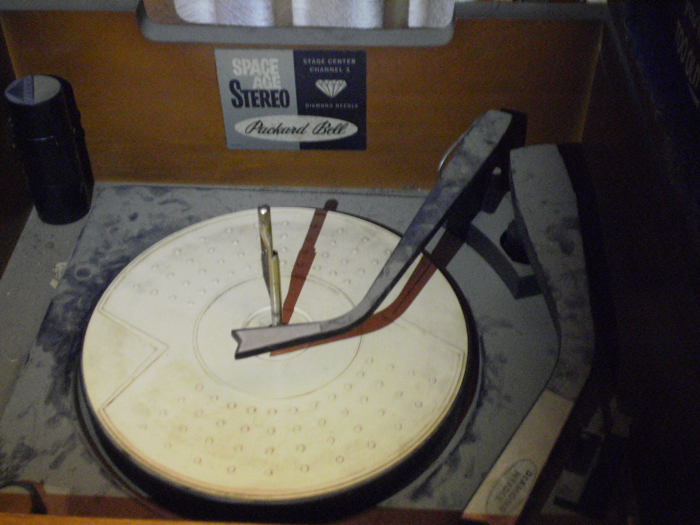

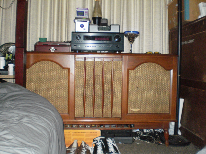

I inherited this wonderful console from my grandmother. My family was going to throw it away so I saved it. I have no info on it other than it is a packard bell. It turns on and plays via the aux (rca style jacks) my mp3 player. The turn table needs the friction spinning rubber wheel gromit ad it deteriorated. And it does not pick up am/ fm signals yet.. i dont have an antenna for it. Any info on this beautiful piece would be great.

It depends on how much you want to keep it. It will need to be properly restored by a service tech who will clean, adjust and lube the changer including the idler wheel. The amp/tuner will need recapped and any out-of-spec parts replaced. Continued use in this unrestored condition will result in the all too familiar "pop" and "fizz" accompanied by a burnt electronics smell. Bottom line... I would restore it and enjoy it.

It's the passing years*** that impact the electronics; not so much the usage when they were in their prime. For instance, rubber and certain synthetic type plastics used for insulators start to break down, harden, crack, crumble and fall away over time, leaving exposed wires, etc., in place. In addition, all of the mechanical components--those used in the turntable/changer; possibly the switches and the tuning dial--need to be inspected and serviced. Until this is done, it's best to leave it unplugged and unplayed.

Judging by the Glaser-Steers record changer in it, I'd venture to guess around 1961 or so.
