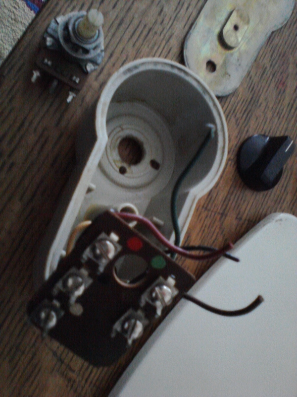

Anyone have a source for a new POT for a Seeburg MRVC-2 ?
I need one as well as a both plugs, the 7 pin for the volume and the 2 pin for the reject.
Also, anyone have a good schematic or is the one for the MRVC-1 the same.
James
PS my M100A manual shows the pot to be a Dual Ganged Potentiometer with one at 16K and one at 5K. Can anyone confirm this? Anyone have a photo of that POT?
