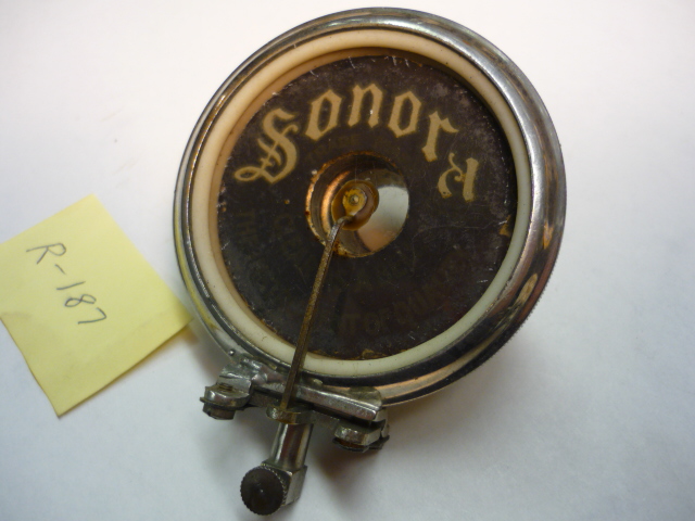

By "one piece" I meant that the reproducer's (AKA "sound box's") shell does not have a removable back--such as a Victor Exhibition sound box , or Victor #2 sound box--or others--that lets you easily remove the gaskets and change diaphragms.
For comparison's sake, watch this video showing the repair of a Victor #2 sound box:
https://www.youtube.com/watch?v=2rhh5_7UYGY
You'll notice that the entire back plate is removed for servicing. Many of the steps shown in this video apply to servicing the reproducer you have, such as detaching the needle bar from the center of the diaphragm, carefully situating the diaphragm between the front and back gasket, etc.
Since the one you have does not have a removable back plate, you'll have to work from the front, as described in my earlier post. Prior to working on it, you'll have to remove the sound box from the tonearm. I'm not sure if it just twists off or not. For that, I'll defer to TripleSpring, who probably knows far more about Sonora Phonographs than I do.
Properly restored, it should look like this, with the mica diaphragm firmly suspended between the back and front gaskets --
(Note: While it's hard to tell, the front, visible gasket is partly tucked under the rim to hold it, and the diaphragm, in place.)
