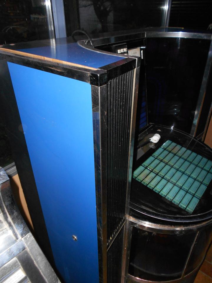

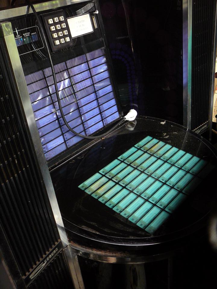

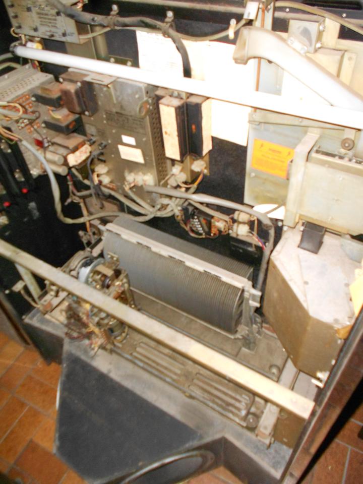

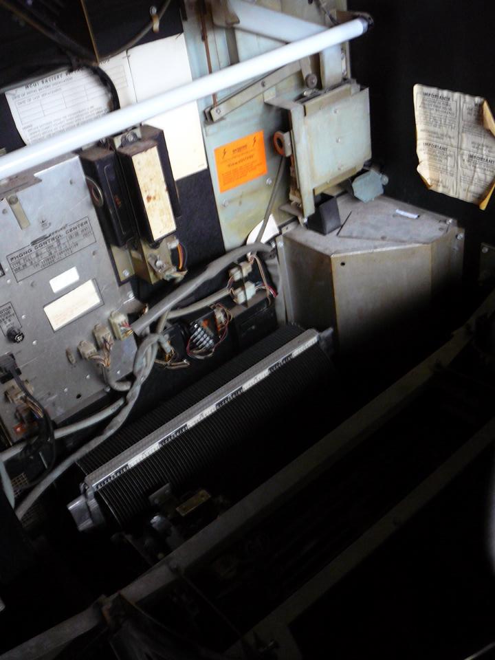

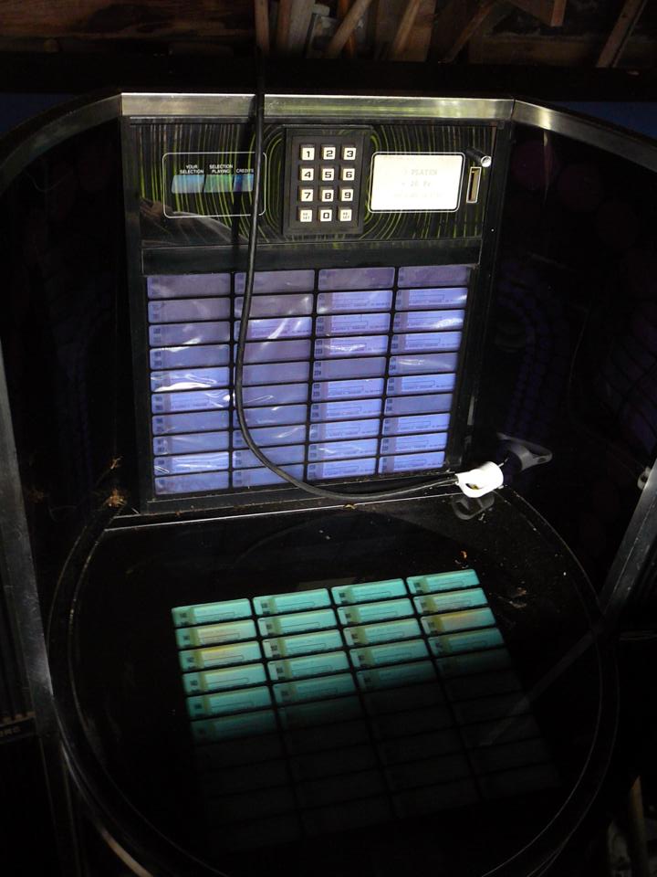

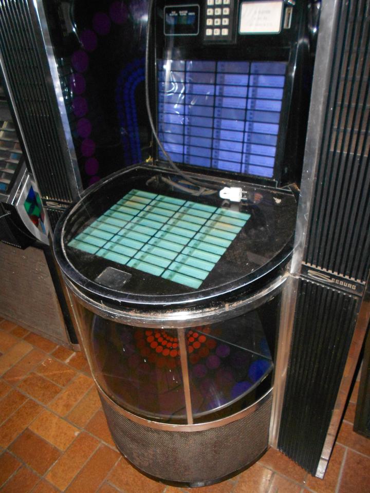

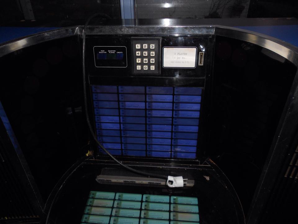

Attached are the pictures of the Disco I'll be driving home for Christmas. I don't really see things that scare me, but anything you guys see I should be checking out?

by Ron Rich » Tue Dec 10, 2013 6:24 pm
Hi William,
I see that at least three parts are missing, inside the cabinet, and I see the turntable paint job is shot. Ron Rich

by MrMario64 » Tue Dec 10, 2013 8:34 pm
What is missing Ron? Do you mean these 3?
The mirror is missing
The black housing on the right side of the turntable is missing
The cable shield is missing??
And what do you mean by "turntable paint job is shot" ?
Re: Seeburg SMC1 "Disco" checklist
by Ron Rich » Tue Dec 10, 2013 9:35 pm
Hi William,
Yes--You have the three missing parts--The "black housing" is usually called the "Mechanism Cover", and, I would call the "cable shield" a light reflector, as that is it's real purpose. All three of these are to "enhance" the "light show" that should be present when the "blacked-out" (painted-flat black) turntable spins. Ron Rich

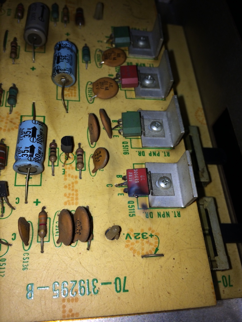

Well, I picked up the jukebox and to finalize this thread here is the list of issues.
1. MCU is not running, display shows static random numbers on startup. Most of the time 8..8..
a) How can I determine if the CPU is running? If that chip is broken, all is lost with this MCU (like is there some heartbeat on an output somewhere to see if the program is running)
b) Are all 3 PCB's needed to test the main board? (just to make repairing easier piece by piece)
2. Amplifier Q5115 is blown (GE309689)
a) When looking at this reference chart here it can be replaced by 2n6292, on the web I found Ron Rich stating a TIP31C can be used. What to do ? And do I need to replace in pairs?
b) Whats is a common cause that makes these blow? Should I dig further to see if other things caused the blow?
3. Mechanism is working, I do not know if the PCC is working, any way to test this without a working MCU ?

On the amp., transistor--It could have failed "on it's own", but I would carefully check the bias circuit, and the output transistors in that channel--Either the TIP (31/32) ( they MUST BE "C's"), or the other one, is a good replacement--and, yes, I do replace them in pairs-

ps. I don't think this transistor blew on it's own:
Boom!
(361.13 KiB) Not downloaded yet
