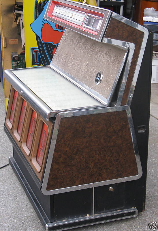

Hello everyone, I'm new to this forum and new to jukeboxes
I recently picked up a 1973 Rowe-AMI Model TI-1 "Seville" .
1st let me say I love my jukebox, it's not the coolest, the fastest
or hold the most value, but at my house it the coolest one ever.
It has a few cosmetic issues I want to try to replace. I'm waiting on
a repair manual I purchased on eBay so I don't know the specific names
of the parts I need, Sorry.
There's a metal bracket that holds the glass and reader strips
Sort of ''L'' shaped and pivits up under the selector switches.
I need both left and right sides. That's my biggest concern right now.
I guess if you have one that's being parted out or knows of one please
let me know.
Thanks for looking

Hello,
I wish you luck with trying to obtain both of the hinged sections for your TI-1, these are now rarer than hens teeth.
The main problem with these was the design and poor operation by users closing the lid.
If and when you replace these, you will need to push backwards on the front corners of the lid, it will then close without effort. The collectorsand site owners just used to slam down the lid breaking the castings at the weekest point.
