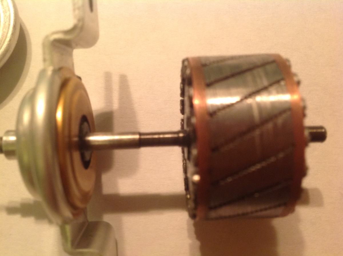

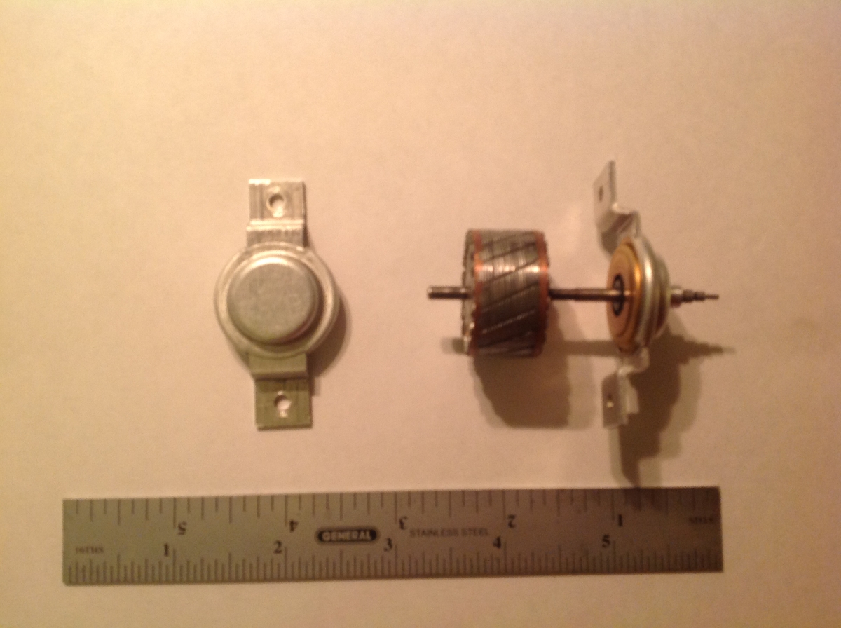

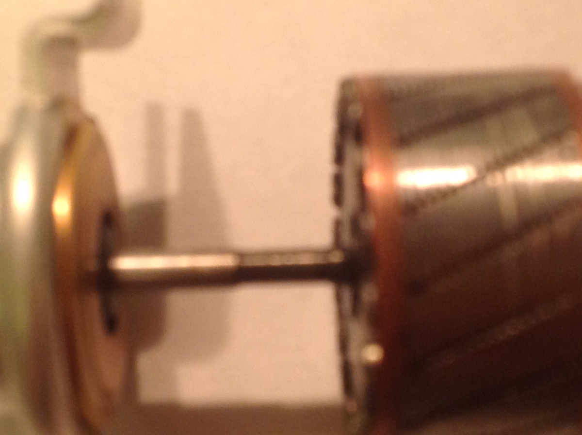

Hear are some photos. Hope this helps.

To anyone who has a "vintage" phonograph:
Those blurry photos above are mute testimony as to what happens to those small induction phono motors over time - IF THEY'RE NOT LUBRICATED.
If you have one, and even if it "runs fine" to you, have it serviced if you value it.
The years of neglect aren't pretty on these things, or your wallet.
A typical induction motor of this sort is likely to set you back as much as $100 these days - simply because they're scarce.
You wouldn't drive a car for 50 years without having it lubed and checked, would you?

Thanks, and sorry about the poor quality of the pictures. Do you know where I could actually purchase one though? That is really what I need.

Ron Rich wrote:I have been able to save many motors of this type, by chucking the armature into my drill, polishing the bearing surface with crocus cloth. Then I clean the bearings, with a "safety solvent", and re-oil it with 20wt ND oil. Ron Rich
Yeah Ron, but look at the pics - that motor is HISTORY!
Worn-down and scored shaft due to decades of running "dry"
And no,... ND20 oil on those changer motors is not acceptable - only lightweight "Zoom" oil.
Because that 20Wt will cause a slow-down of speed, noticable on records.
I know this for a fact.
