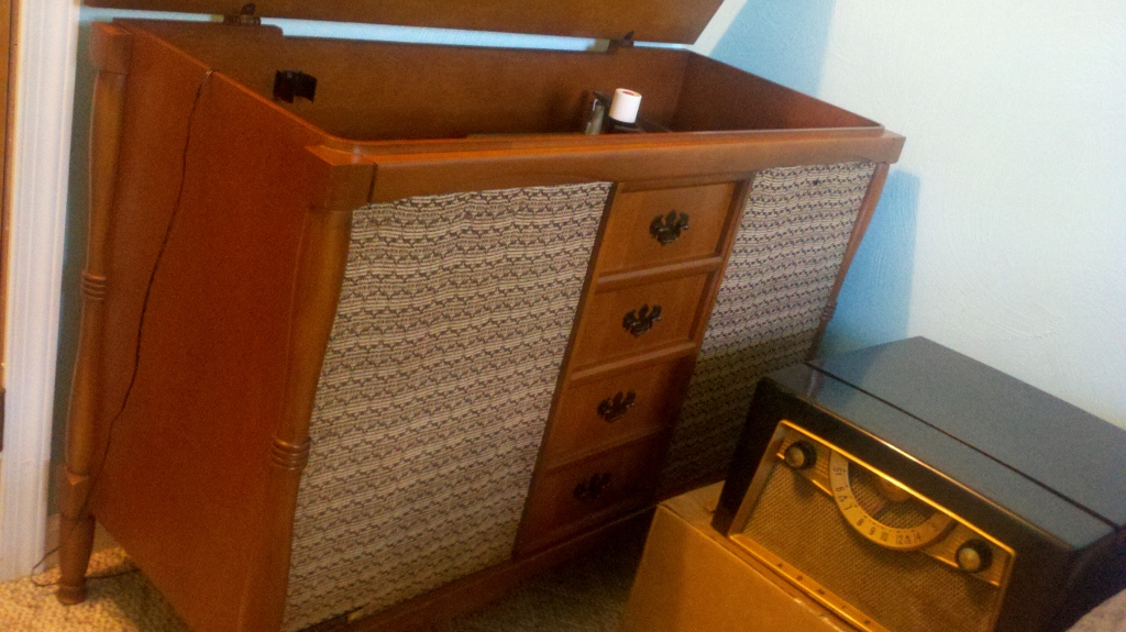

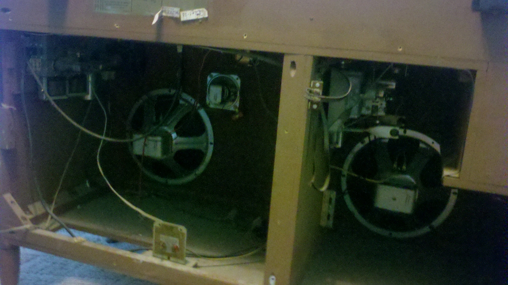

Ok, here are some pics of the set. It had been purchased by my buddy at a yard sale in 1999, and had been in his basement ever since. I spent about 5 hours cleaning and polishing, and it now resides in my bedroom! My issues with it are: 1) Cartridge cuts out, requires a light tap once in a while. I will just replace it. 2) The right speaker barely makes a sound. The tiny wire which runs from the connectors on the back of this speaker needs soldered, but when I touch it to the connector, I still barely get any sound even when rotating the balance to the right completely, volume all the way up. 3) It only softly hums when I click it to FM stereo, no station pick up at all. FM mono works fine, as does phono stereo and mono. Thanks for looking everyone!

by MattTech » Sun Jul 17, 2011 6:15 am
I'm quite familier with that RCA.
1960 vintage.
Low/no sound - it needs probably re-capping of the amp, or you'll blow tubes continually.
One of the 6BQ5's are probably already bad because of it.
(swapping them will clue you in)
Additionally, sounds like you'll need a new speaker too.
As for no sound on FM Stereo - you don't have the CRK101 stereo-multiplex adapter (sold optionally at the time) so that function is basically non-functional.
I can tell from the photo it's not there, or it would be mounted near and connected to the tuner (chassis RC-1206).
The phono cartridge is shot from age too, a newer upgrade can be installed and a good healthy overhaulling/re-lubing of the changer mechanism is a wise thing to perform.
(would you drive a car on 50 year old oil and expect it to be safe?)
I've worked on plenty of them at the shop and they sound great once restored properly.
A 50+ year old console should never be even plugged in until proper servicing has been done to it.
