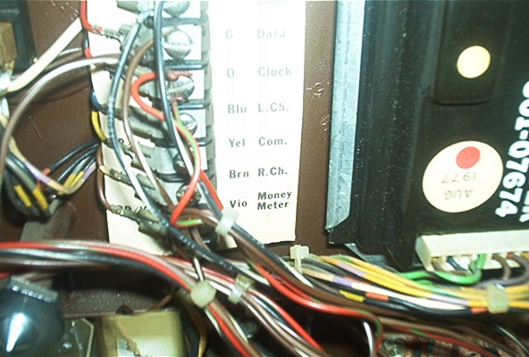

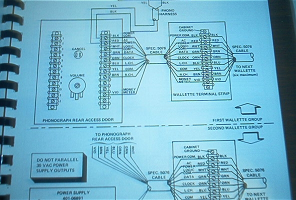

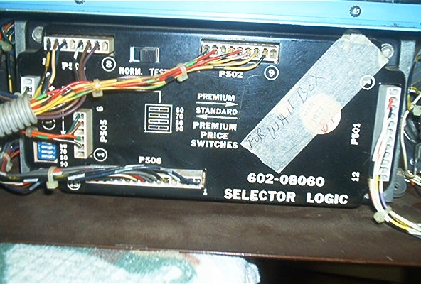

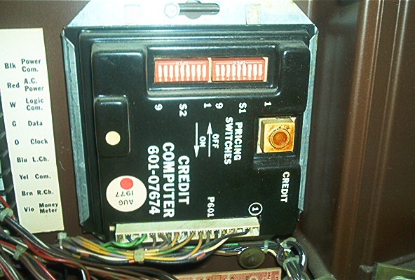

by rpucci » Sun Sep 23, 2012 7:21 pm
Hi Alan
I going to try and send the pictures here,since your not getting them by email.
Bob
Re: WRD Interface
by ami-man » Sun Sep 23, 2012 7:39 pm
Hi Bob,
Thank you for posting the pictures, the interface I have had on test will be what you need for to connect to this wallbox.
Please contact me off of list if you want it sending out to you.
