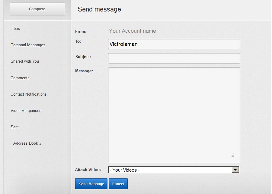

I don't have an email or phone for him, but if he has his account configured to accept personal messages via youtube, all you have to do is go to your youtube inbox, which is listed under your account name.
Click on that, and on the next plage, click on Personal Message, then click on the Compose button.
Fill in Victrolaman in the box next to "To:", type a subject in, compose your message and then click the "send message button."
The page for personal messages should look something like this:
