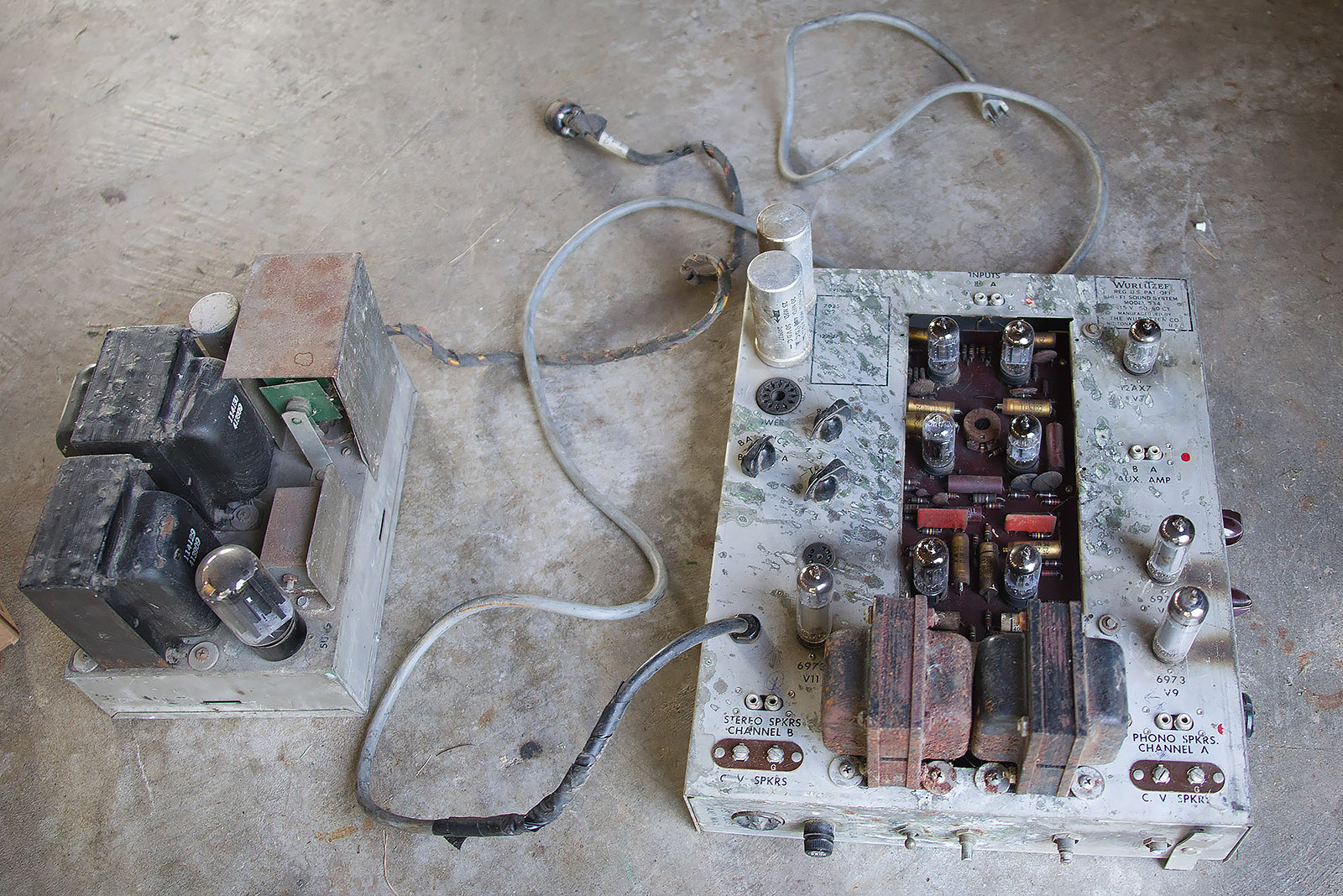

So I opened the box and detach Power supply and Amplifier. This is how it looks:
(607.6 KiB) Not downloaded yet
Can you please take a look on the photo and say what first thing I should start checking?
Few more thoughts:
-I see soot near Amp tubes, but tubes looks good. Probably previous owner change it.
-Huge tube on the Power supply looks blown inside. Big black spot inside on the top. Probably I should start here.
-There were two power inputs (power plugs) into jukebox. One is going directly to the Amp, second goes to light ballast. Is that normal?
Thanks for any comments!
Re: how to start with repairing project
by Rob-NYC » Fri Jun 06, 2014 10:07 am
The large tube on the separate power supply is the 5U4 rectifier that supplies the B+ (high voltages) for the amp. This tube should be left out till the amp has been rebuilt. the black/silver spot is called a 'getter". During manufacture is it heated by H-F induction to further improve the vacuum. It is not a fault.
The amp needs a good cleaning and the rusty tran looks like it has been exposed to longterm moisture. Keep fingers crossed.
Those printed boards are easy to work on. There is a slight chance that some portions may have become carbonized and defective, but I suggest you just go ahead with cleaning and capacitor replacement. I have never run into that problem on Wurlitzer boards of that era but I do believe unpopulated reproductions are available if necessary.
If you have basic soldering skills and simple tools like a DVM you should be able to rebuild this amp easily. The 6973 tubes are prone to internal shorts and they can take out a transformer, but since Wurlitzer used cathode bias the cathode resistor will have taken most of the hit.

Finally rainy day comes and I found a time to come back to my restoration project.
So I ordered WURLITZER 538 STEREO amp cap kit, but when I take a look on the washed amp label surprisingly I found out it is a 534 model! You can see label in my previous attached pic on the right top.
Can you please help me understand:
1. How it can happened that Wurlitzer 2410S model has 534 amp? It looks original... The only thing comes to my mind that previous owner changed amps from 538 to 534.
2. How different capacitors in 534 comparing to 538?
3. Does it make any sense to rebuilt 534 amp for Wurlitzer 2410S? Will it work anyway?
4. One of the 6973 tubes broken, and I found 6LJ8 tube in box - looks like previous owner bought it as a replacement for 6973. Will it work or I need original 6973 (or cheaper 6cz5)?
Thanks a lot!
Re: How to start with repairing project Wurlitzer 2410S
by Rob-NYC » Fri Feb 13, 2015 1:14 pm
Well, that took a while.
-The 6LJ8 is not remotely useable here. Forget it. It is an American version of a dual section European tube.
-The amp should be fine there. The only difference (that I recall) was that the 2300 series amps still used a 5U4 in the PSU and the 2400 series went to diodes. Since you have the correct PSU, all that matters are the mute-squelch plug mating -they should. I do not recall any other differences. In summer 1986 I bought 9 various Wurlitzers . All were the 2300 and 2400 series. They came straight from a warehouse and many were missing parts. We just rummaged around for what looked approximately right and I made them work. The 534 and 538 along with two 532 (mono) amps went into those machines -whether they liked it, or not :-)

So the good news is I can use this 534 amp with Wurlitzer 2410s. Looks like PSU is also from 2300, it has 5U4 as you mention.
Sounds like it will work with 2410s, right?
