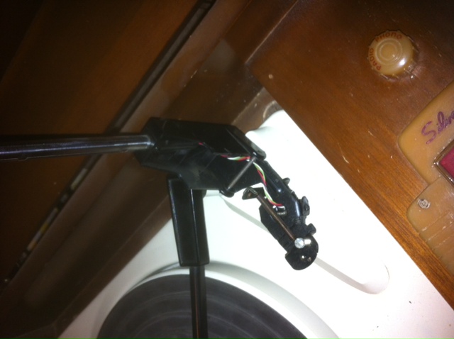

here is the tone arm
photo (1).JPG (80.2 KiB) Viewed 1280 times

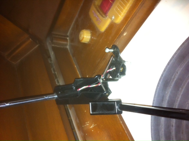

by indierockcole » Mon Apr 29, 2013 12:09 am
another picture from a different angle...
photo (2).JPG (82.35 KiB) Viewed 1280 times
Re: HELP PLEASE!!SILVERTONE PHONOGRAPH/RADIO
by MattTech » Mon Apr 29, 2013 1:07 am
Looks like a typical butcher-job of a 1940's radio/phono with a more modern 1960's record changer of some sort... lord knows what else is amiss. :shock:
orthophonic
Posts: 36
by orthophonic » Mon Apr 29, 2013 11:06 am
Yep, a 60's changer installed in a 40's console. You didn't show much of the changer but it looks like an
Admiral Ensign or the one sold by Allied that was made by Admiral Ensign.
by MattTech » Mon Apr 29, 2013 5:59 pm
Looks to me like that's an even cheaper changer.
A Maestro brand "replacement" changer that sold for $19.95 back then.
Horrible thing it was, and still is.
