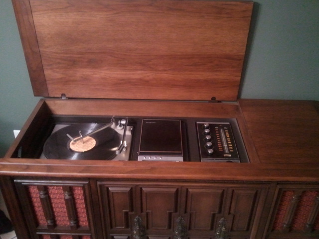

Here she is

I am not familiar with that changer, however, most "automatics" have some sort of "sensor" that indicates if there are more records "sitting on the spindle". This is usually connected, in some manor, to the arm that "swings" over the records, and holds them, prior to the spindle "dropping them". When no more are sensed, the tone arm will return the pickup arm to the dock, as you describe. Therefore, I would assume that the "sensor" is not functioning for some reason--probably "gummed up" from lack of use-- Ron Rich

You were right the first time.i found some sensors that were mucked up with old grease. i cleaned them and applied new . Works like new now. Thanks For the help!
