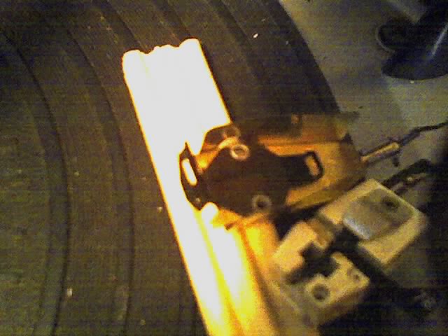

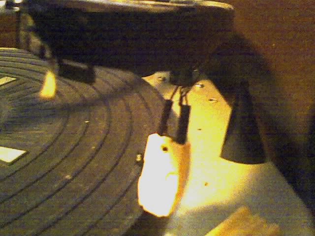

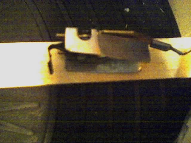

Okay, I'll try this again.
I took some grainy photos of my Astro-Sonic out in the garage 5:30 this morning. For THIS particular setup, the single screw holds the mount (within a mount). If you pull the black clip forward (to the right of the record brush in the pic), the cartridge pops out. The inner mount also has holes for cartridges requiring two screws, then mounted to the outer mount that has that single screw that you see from the top of the tonearm.
In the third pic, I removed the mount so you can see it side-by-side with the cartridge, which is an Electro-Voice 506. Another person with a similar model on here has an Electro-Voice 505. I don't know the differences.
My other similar turntable has a different cartridge, so I just loosen the screw on top of the arm and the whole unit drops out. Once you remove that, you can see the two screws holding the cartridge in place. This is not a "pop out" cartridge like the one mentioned above.
I hope this helps in some way. Gotta keep these beast roaring. :D --BB

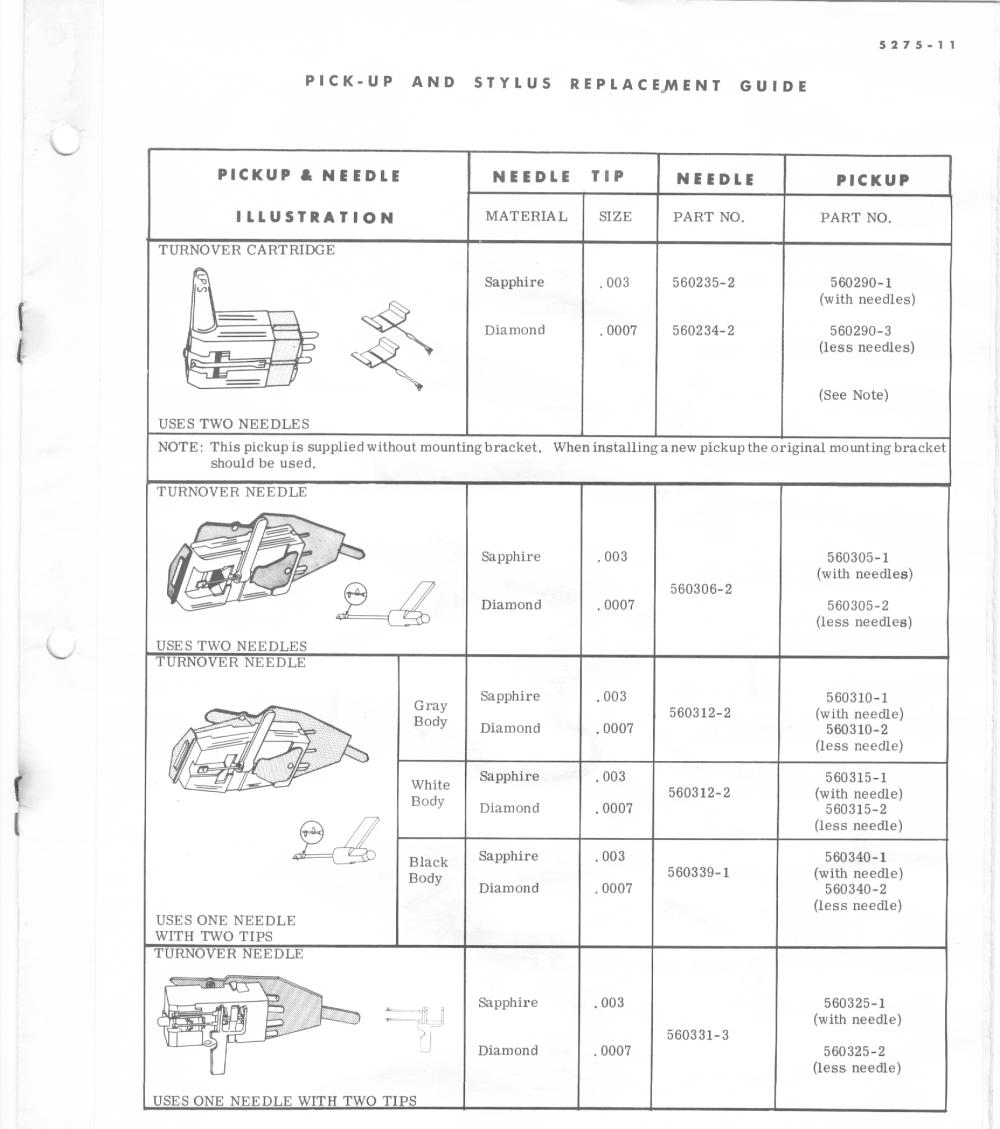

For the feather touch Micromatic turntables used in consoles from around '62-'66, I've tried to attach the Service Manual pcitures. Regarding both needles and cartridges, the best vendor I have found is needledaddy on eBay. He not only has new old stock, but he tests each cartridge before sending it out - and at reasonable prices. Once at his eBay store, you can click on Magnavox and find what you need. If there are no cross-reference numbers there, e-mail him the Magnavox part found on the uploaded file and he will let you know if he has it (which he probably will). I've purchased about 30 cartridges and needles from him over the past few years and each one has been perfect - still working great. Also, Radio Shack online still has some of the needles for some of Magnavox cartridges for the Micromatics for about $5. When you get to the Radio Shack home page, you'll need to do a site search using the word stylus. Once you get the cartridges and needles, if your Micromatic drags or has other problems, feel free to e-mail me for some tips on getting them up and running correctly. I have serviced around 20. If you have trouble reading the uploaded file, e-mail me and I'll forward it to you.
Tom
Email: dpiltes@bellsouth.net
Micromatics: 602-608
(107.4 KiB) Not downloaded yet

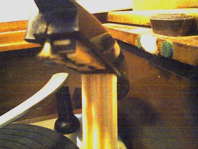

by Bobby Basham » Sat Aug 28, 2010 9:50 am
If you scroll down to the Electronic Gramophones and Phonographs forum, there is an FAQ there about needles and cartridges. I used to get alot of needles for about $4.99-5.99 for my Astro-Sonics.

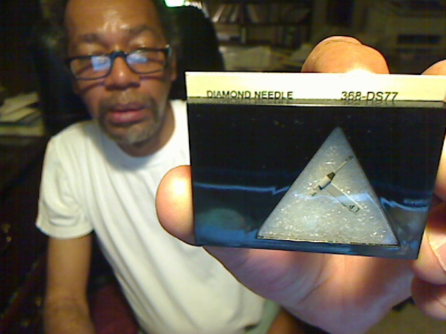

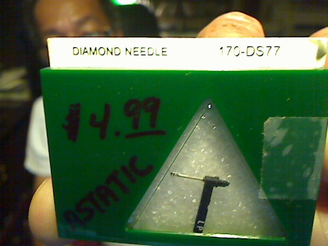

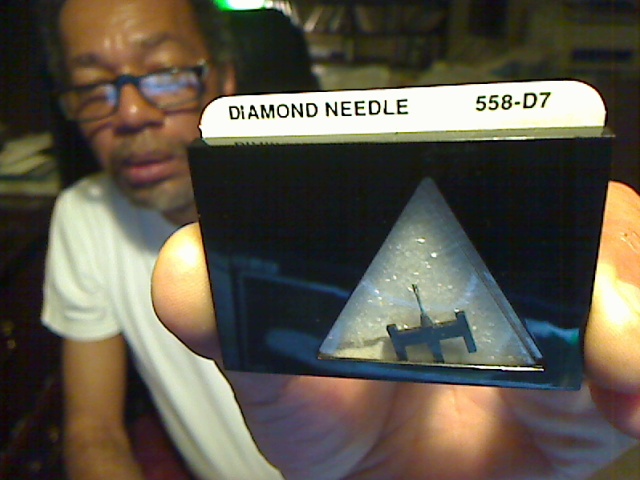

If you have an Electro-Voice EV275 or Astatic 165D, there could also be a Magnavox number stamped on it like 560345, and a couple of different needles will work. I've seen some of these smaller cartridges in GE consoles and a larger version in some Zeniths. If you get the number off the cartridge, then your needle should be an easy match. Look at the attached pics below. --BB
