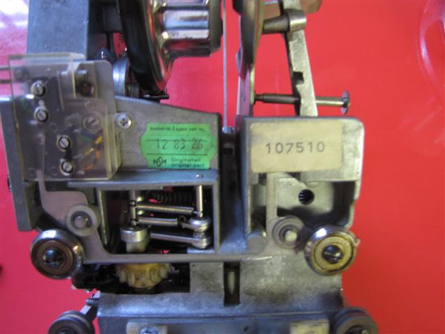

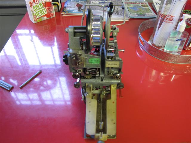

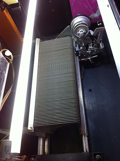

Had someone local to me who has same jukebox, pull their carriage so I would have some reference pics, so I believe this is the correct one I need:
Re: Festival 130 carriage same/compatible with a 160?
by ami-man » Mon Mar 03, 2014 12:52 pm
Hello Tim,
Do you have the trailing ribbon cables that go to the mechanism still on the jukebox or you need to locate these as well?
As a reference I would visit the Stamann website www.jukebox-world.de and look into their Archive section to look at relevant information on your model of NSM jukebox.

by jukeboxlol » Tue Mar 04, 2014 1:32 am
Hi Tim That picture is the correct carriage and the ribbon trailing cable should be grey in colour
by NSMES160Jukebox » Wed Mar 02, 2016 6:15 pm
Hi, I have the Es 160 and it looks the same... Do you have any idea of the voltage value for the Varistors VR100 & Vr101?
by clones » Wed Mar 02, 2016 8:35 pm
The carriage in the photo is the same as in models from the latter part of the seventies and early eighties ES II technology. If your festival is a 130 it may be the model from the late sixties and is belt driven and the above carriage in the photo won't suit.
by NSMES160Jukebox » Wed Mar 02, 2016 9:59 pm
Think its very early 80's model... bit of a Starwars vibe about it :)
by clones » Wed Mar 02, 2016 10:47 pm
Yes that one above is a festival from the late seventies to early eighties, there was also a festival model130 from the sixties
