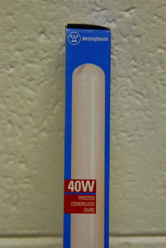

Hi - does anyone have a photo of the light fixture behind the jewel casting in an AMI A? I'm restoring an A that appears to have never had one, and I'd like to add one to illuminate the jewels. Would like to see fixture, mounting, etc. Any help is appreciated! Thanks, Carl.

In the AMI Model A jukebox equiped with jewel lightning, the 40 watt T8 medium base showcase lamps are used to light up the AMI A jukebox jewels.
40 watt at 130 volt 3500 hour life. 11 1/2 inch long clear glass.
I attached a pic
