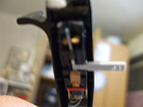

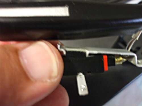

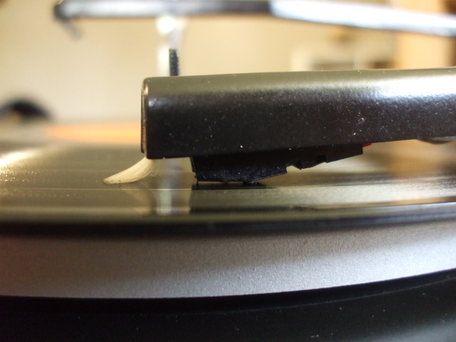

No, the motor mounts and idler wheel were is good shape..still supple or soft whatever but I think I might have found the problem the rubber boot
that joins the stylus stem to the stylus body is rubbing on the record and I think I'll try to lighten the tonearm I'm pretty sure the screw at the back/
underside of the tonearm will make that happen...I've included a pic of the headshell/cart./stylus....if I'm wrong and that is the correct heigth of
the cart from the record let me know please.
Posts: 8194
Re: Magnavox Spirit of 76 Question
by Ron Rich » Mon Apr 30, 2012 3:41 am
Deash,
Whoa--Stop ! Something is defiantly wrong with this picture !
Nothing other than the needle should touch the record ! That "brush" even looks suspect.
Could it be that the cartridge has broken loose from the clip in the rear ? Or is the clip bent ?
Needle pressure should be no more then 7 grams MAX--probably more like 2-5 grams on that phono.
Someone with knowledge of that model, or a Service Manual, plus a gram gauge is needed here. I would not advise you to "turn screw(s)" !
by MattTech » Mon Apr 30, 2012 5:35 pm
Right on, Ron!
That tonearm should be tracking at around 3 grams, 4 tops.
Either the needle assembly is defective, or the cartridge yoke is crushed/damaged, or someone was messing with the tracking weight adjustment.
The way to adjust it properly is with a gram gauge, to 4 grams - allowing around a gram for the brush offset.

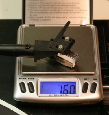

Ordered this from a vendor on eBay for $30 ....how do you go about setting the tanget tracking on these old Hi-Fi's??? I recently bought a console at a auction

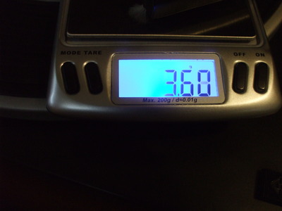

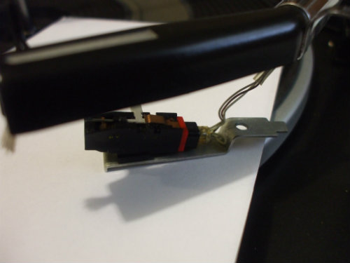

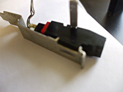

O.k. I have the stylus tracking force set at 3.60 grams and that made no improvement. Still looking for help with this, the cartridge# 560389-1 and that is the cart. that came with it and looks correct as you will see in the pic's....the needle is 396-DS77 I bought this from NEEDLEDADDY1 on eBAY and is identical to
the one I found broken in two under the turntable. I've taken some pic's of the cart. and clip out of the tonearm maybe someone has some advice....again I bought this at a garage sale and have no idea what the previous owner did to this player?

Are you sure that is the correct pickup?
ALL of the Maganvox sets that I have seen used this cart (scroll down):
http://www.antiqueradios.com/forums/vie ... p?t=126020
A version of this but with 1/2 in mounting ears was in the 1965 model that I have. I replaced it with a Pickering magnetic.
Given that the cart seems to be bottoming at it's mid section, have you tried bending the "tail" slightly to produce a better angle?
by Thom » Fri May 04, 2012 6:12 am
Does the cartridge still bottom out on the record? If so then the cart is most likely shot. Though a little out of focus, the yoke on your closeup of the cart looks damaged or at least shot.

by deash » Sat May 05, 2012 2:06 am
Upon closer inspection the yoke has deteriorated and need's to be replaced.
