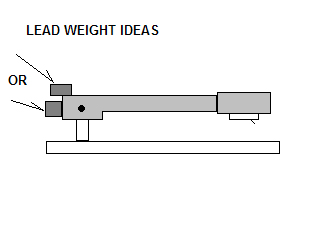

If need be, on top of the arm, behind the vertical pivot, a lead weight could be fixed, to counterbalance it.
A lead fish weight, sliced to the appropriate size/weight (trial/error)?

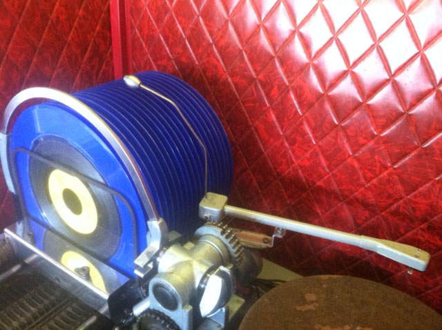

Todd Kaser
Joined: Thu Jun 13, 2013 6:36 pm
Location: Bristol, IN
Re: AMI D-40 Tonearm Weight
by Todd Kaser » Tue Jun 18, 2013 12:00 am
This is what I came up with. It is not pretty, but it is functional.
by Ron Rich » Tue Jun 18, 2013 12:19 am
Todd,
I am sure you have heard the old saying: "Beauty is in the eye of the beholder"--well,
I think it IS "pretty"-- Ron Rich
by MattTech » Tue Jun 18, 2013 2:44 am
WOW.... is all I can say!
:shock:
