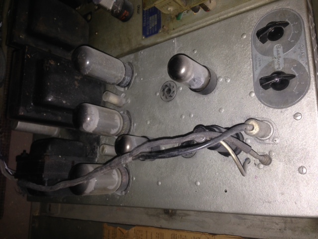

Viewed it today. Would love to hear all the thoughts on if the findings below mean that approx $2k is still a good deal, and anything that sounds expensive/hard/look out for (lets leave the whole moving bit for now, until deal is made)
It works - but is not as loud as I'm sure it should be -the video here is on full volume. https://www.youtube.com/watch?v=1RvYdEcUz0E)
Also seemed to start very quiet and get louder over 5 minutes.

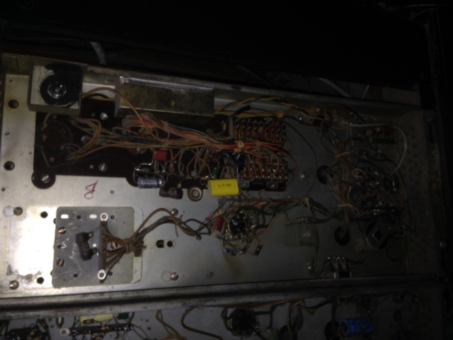

First up, the caps - looks like some have been replaced (is that common to do just some) - and assume I would need to do all - does not look to bad a job to replace as not too many. (Plus volume knob missing, but did turn and work - just, as per above, not very loud)

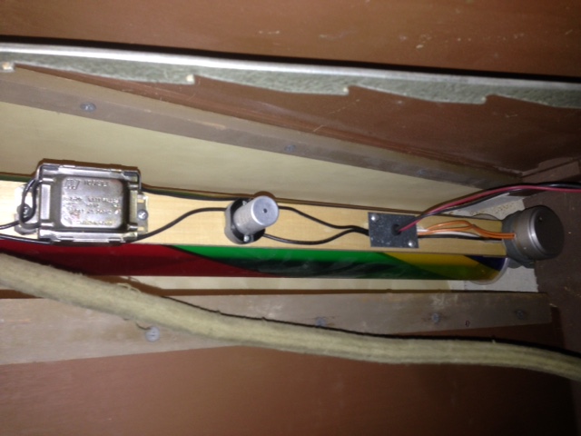

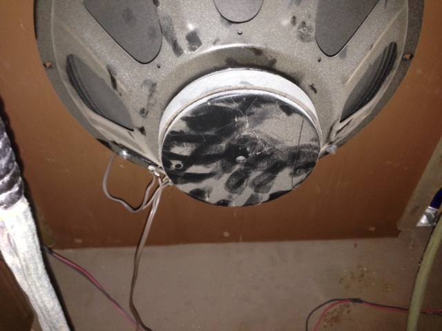

Speaker wires were joined - normal or sign of replacement speaker (and if so, can you tell if correct one?)

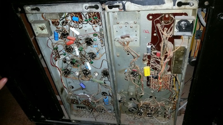

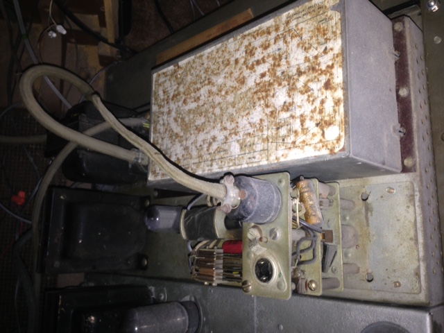

Amp & whatever is next to it (sorry - said I was new to this!)
These were on both side - looks modern?

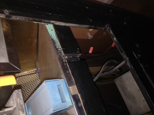

Also pilaster lighting turned very slow compared to some I see on YouTube. no big deal.

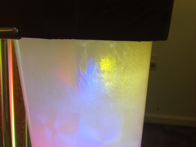

Pilaster frosting worn at top

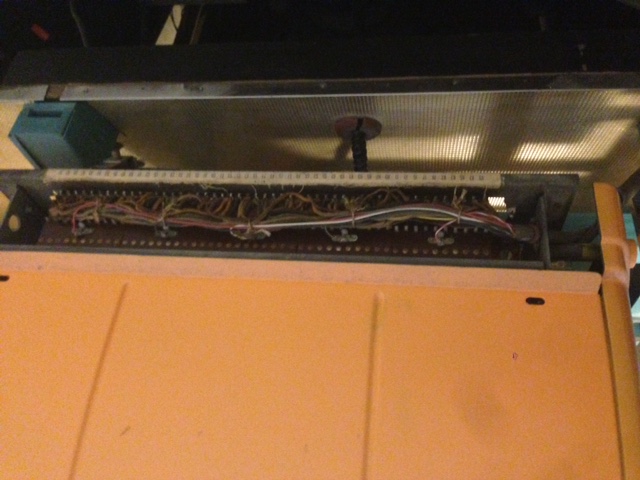

Couple of other pics:
IMG_2208 copy.JPG (98.94 KiB) Viewed 566 times

What I can see from photo's--
Wrong speaker--missing AVC tubes in amp (No "volume control knob" was ever issued with this model--an insert-able "key" was, and is still available, as a poor repro). It would be my opinion that this amp needs more then just a "cap kit"--. Ron Rich

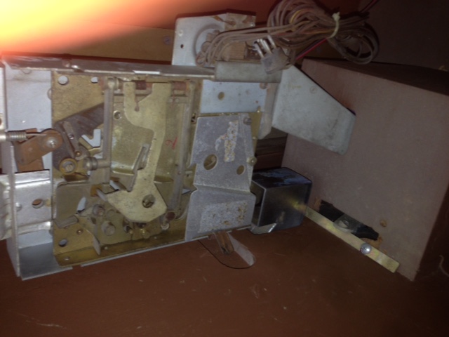

In picture 2200 the credit control cover is missing. They usually go for $25 on ebay. Is the stepper underneath the cover and does the stepper work? Stepper cover is shown in picture 2200 and is used if you desire to hook up a wired remote control wall box.

Thanks Ron and Darrell. This gives me some idea onto extra $'s needed.
If the speaker is part of the problem, or I just want to bring it back to original, then they seem to be $200 on ebay (http://www.ebay.com/itm/SEEBURG-C-G-or- ... 4d3535bf8c)
While I think I could handle caps and resistors, I have no way to test tubes so I assume thats approx $300 to get a pro to check/rebuild the amp - plus I'll need those AVC tubes (although may be cheaper in long run to get complete set? I see thats $140)
Stepper - don't know, Darrell. I could ask seller to send a photo tomorrow - they did mention they have the wall box somewhere but have not found it yet. (Not something I'll use I imagine, but maybe get them to throw it in)

Some general thoughts on your observations and pic's.
-The speaker has been changed. the original was a field coil type. The replacement is permanent magnet. When this is done it removed a large load from the B+ power supply and the voltages go up considerably. The standard solution is to place a resistor as a dummy load across the power supply as a sub. looking at the underside of the amp, I see a large green resistor right near the 5U4 socket. This is not original and is probably the dummy load. The resistance should be approx 6k-ohm.
There is no way to tell what the type or efficiency of that replacement speaker is by the pic. Since 15" is not a commonly used size outside of musical instrument amps, it is possible that is what is in there. If so it will be efficient, but very lacking is anything above 2-3kHz. In any case, a simple addition of a crossover and tweeter is necessary to make full use of the new cart and for pleasant listening. Our perception of "good sound" has vastly improved in the intervening 60 years since this machine was built.
If you go with an original speaker, it will most likely have to be reconed and the amp mods, which may be very simple, be removed.
-Low volume. Starting with the new cart used here. The 345-03d is far superior to the original black or red head. however it's output is considerably lower. unless the preamp is modified for greater gain, maximum level will be a -bit- lower. It should not require a full-up volume control.
Weak tubes or low B+ along with an inefficient speaker can also cause low volume. I note that the bass and treble controls are not full on and this will reduce apparent volume.
It is not necessary to hire someone to test tubes. That is a waste of money and time. The tubes that directly affect gain are the 6J7, 6SN7 & 6SL7. A better use of funds is to simply buy new ones, both for test and spares. A 5U4 is a good idea too.
Given that the amp appears to have been rebuilt there is no good reason to go over it again. A few voltage readings will tell you if there are any weak areas.
If you wish to use a wallbox, the stepper will have to be serviced. It may have been done when the units were restored, but the rectangular 5Mfd cap on the right side of the unit must be replaced. NBD.
There are some other issues to consider, such as whether the tonearm has been rebalanced to accommodate the lighter cart but over-all I'd say that given this is one of the most desirable 1950's Seeburgs and has been tastefully restored (no Betty Boop or Elvis graphics) at 2K or less you have a good deal.

I would check B+ first thing. If low, take a look at the green resistor that Rob mentioned. Probably the reason for low volume. I would not just "replace the tubes". A couple of reasons....."Time" does not make a tube bad. Only use. Tubes last a very long time when only used occasionally in a home. Second reason is....that is the advise people always give someone who is restoring a tube radio, amp or jukebox. A lot of good tubes have been replaced. So when it was "restored" the tubes were probably replaced..."just because".
