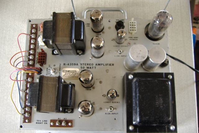

Hybrid sound system with a 50 watt tube amplifier with seperate transistor preamp box. The tube amplifier contained a built-in output transformer package.
R4359A tube amplifier
R4359A amplifier.JPG (46.82 KiB) Viewed 1183 times

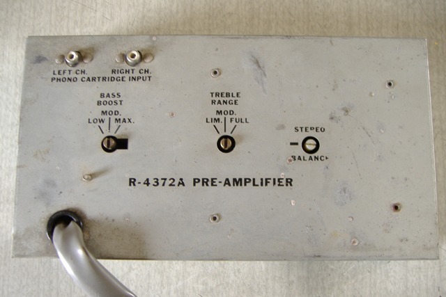

R4372A transistor preamp box
R4372A preamp.JPG (58.26 KiB) Viewed 1183 times

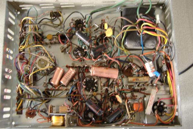

R4359A underside showing components
R4359A underside.JPG (54.91 KiB) Viewed 1182 times

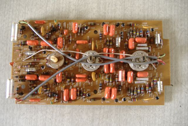

Preamp circuit board assembly information.
# 601-03758 Preamp PC Board Assembly, models MM3 and MM4
# 602-03758 Preamp PC Board Assembly, models MM5 and MM6
Recapping this board:
Both versions use five 5 uf @ 25 volt axial electrolytic capacitors (C6L, C6R, C23L, C23R, C28). Use modern 4.7 uf to replace the 5 uf ones.
One 100 uf @ 6 volt Axial electrolytic capacitor (C26). Use a modern 100 uf @ 16 volts to replace it.
Only a total of six axial lead electrolytics need to be replaced.

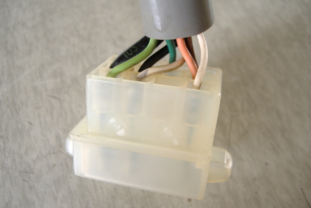

This connector plugs into the tube amplifier
R4372A connector.JPG (48.47 KiB) Viewed 1157 times

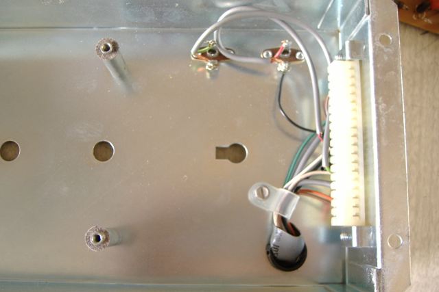

Preamp box interior with board removed
R4372A interior.JPG (29.56 KiB) Viewed 1157 times
R4372A board.JPG (55.1 KiB) Viewed 1157 times
