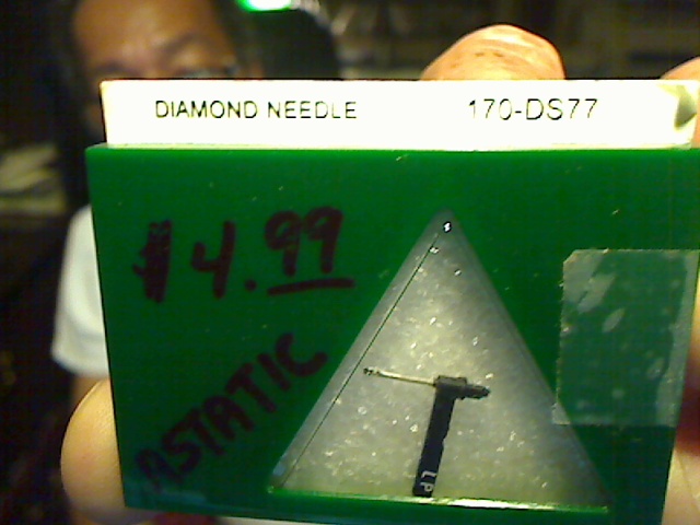

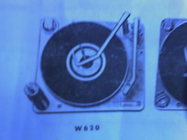

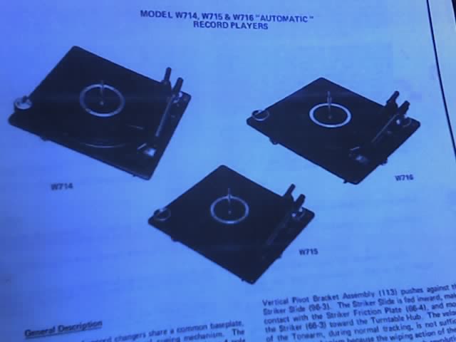

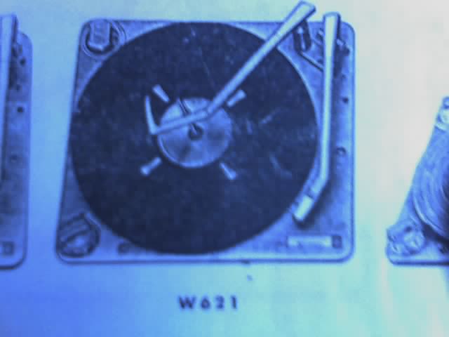

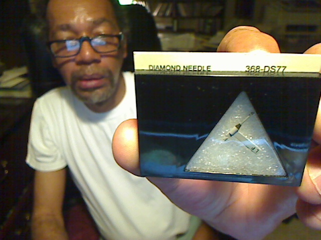

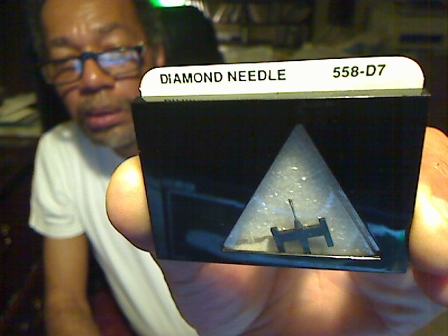

If your unit dates to 1969, you may have a turntable like some of the ones pictured below. They may use an EV-275 or an Astatic 165D. They may also have a Magnavox number on it like 560345. It's been several years, but I think these needles were $4.99 to $5.99 at Radio Shack (online only) and I have used several different needles with those cartridges. Some of those needles have a longer rear stem where they snap into the cartridge, so they may not work unless you trim it with some nail clippers...hey, bether than nothing and it seats snugly. --BB
