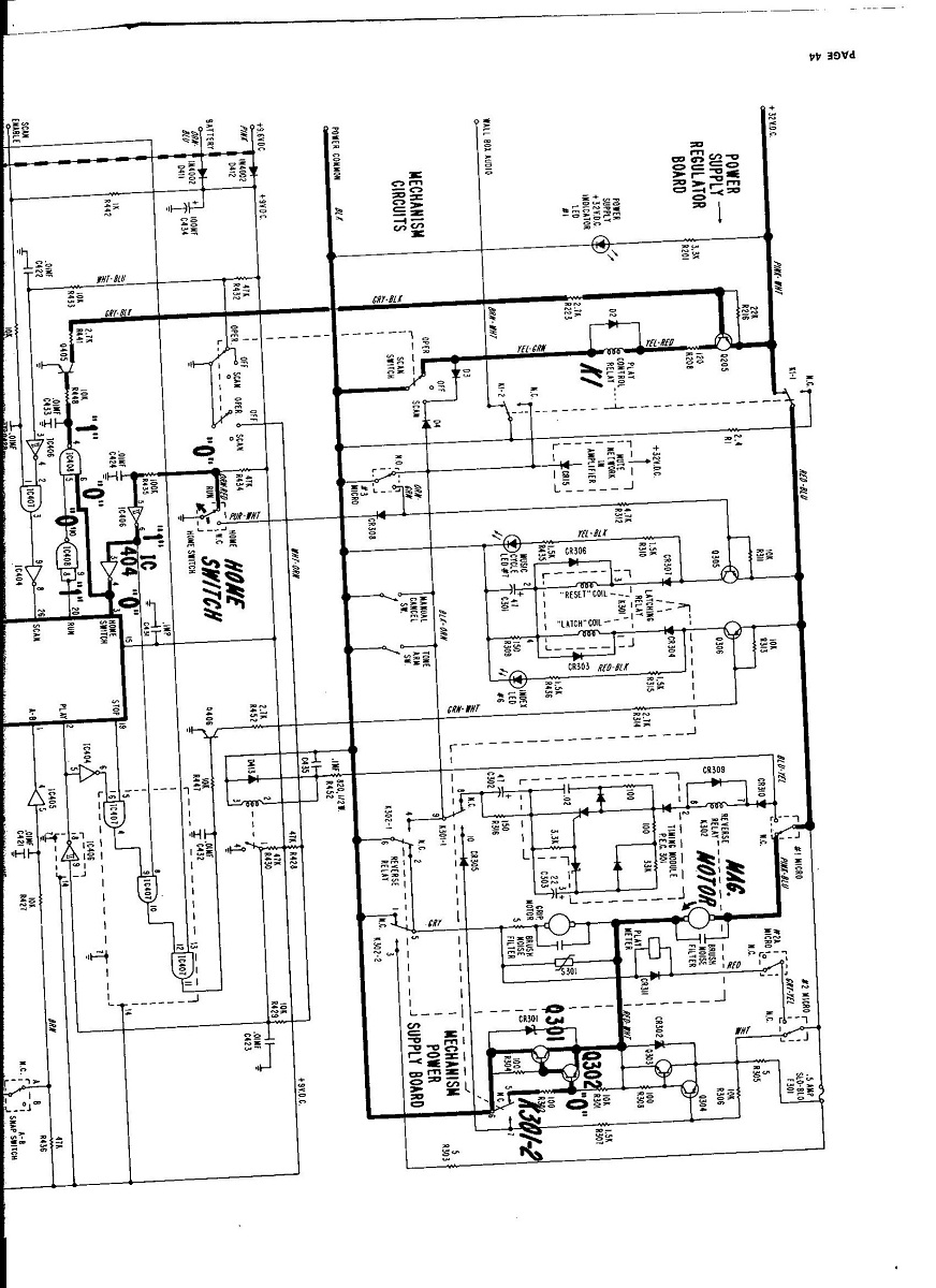

So I was able to use Sequence #11 in the Seq guide for the magazine motor operation. According to the schematic the motor uses +32V that comes from the power supply to the mechanism board on the lower bottom of the juke. I tested for voltage at the mech board on the pink-blu wire connector based on the schematic attached below. When I ran the basket motor (home micro switch on the opto board) I got an output from the meter of 28V. The power supply also has a led to show that the 32 v power source is ok based on the service material information.
-Jason
(293.17 KiB) Not downloaded yet
