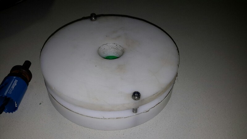

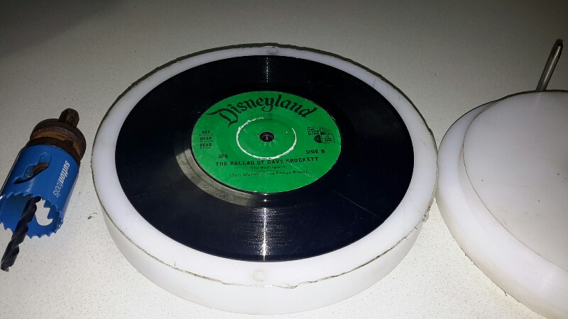

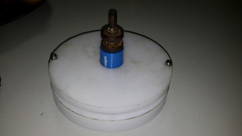

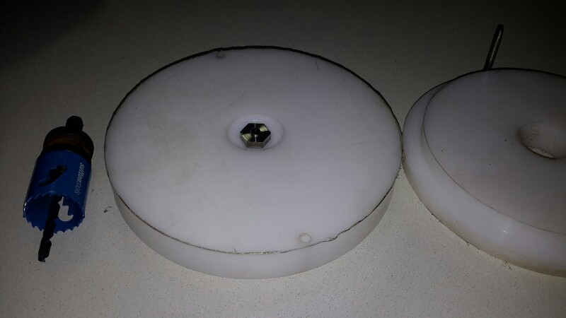

by hdt22 » Mon Aug 15, 2016 12:18 pm
Hey Ron,
Thought i might share my attempt at a dinking tool, no test yet as i want to do a couple more things when i have 5.
