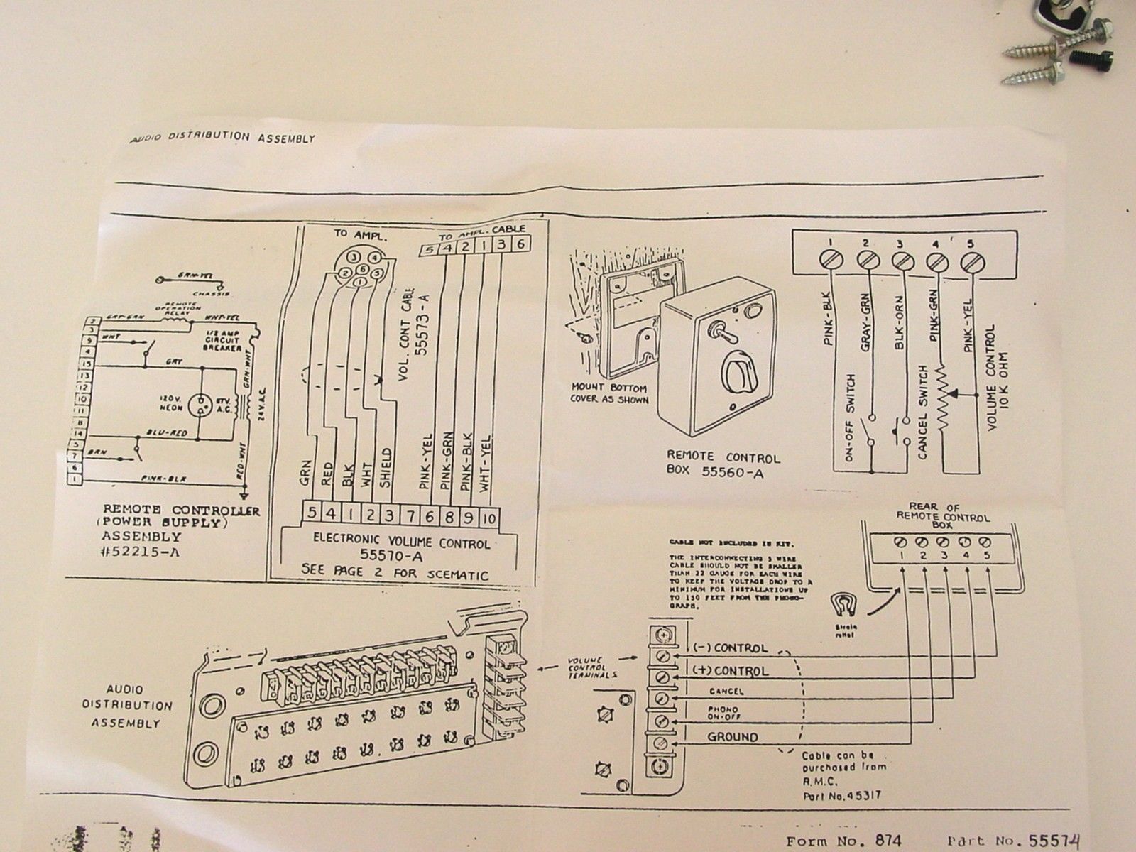

Okay, so I managed to get an NOS remote volume kit that includes power. The kit does not come with the 5-wire unshielded cable that connects the remote box to the power and speaker distribution block on the jukebox (see attached pic)
(265.14 KiB) Not downloaded yet
Since the wires are unshielded, can I just take 5 wires of 20 or 22 guage, bundle it together and use that? I'm assuming I can but want to make sure.

by Ron Rich » Thu Sep 25, 2014 7:11 pm
Hi Robert,
The correct wire is Beldon #8445. This is 18 gauge, stranded wire. Depending on how long your wire is--either 20, or 22 gauge, should work just fine--Don't use "solid" wire. Ron Rich
