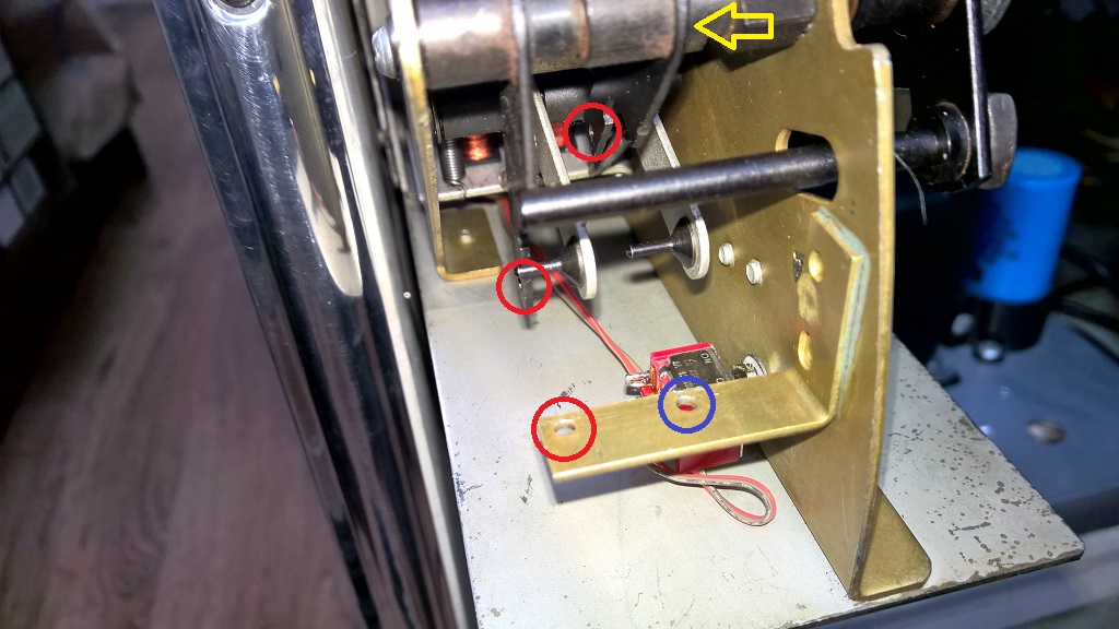

Ok, so I think I have this one figured out now. As you said, Rob, it was a mechanical issue. Taking a closer look, there are a couple of springs missing from the hub and lever/lockout assembly. As soon as the coin magnet triggers, it looks as if there are a couple of catches that should hold the release levers in place, allowing the credit accumulator to settle. When a selection is made, the catches are disengaged by the driver pin on the cancel wheel.
One interesting thing is that the catch for the quarter pricing mechanism (yellow arrow) is stuck way back, whereas the dime/half-dollar catch is free to move. I haven't tried to release it yet, but hopefully it will just be a case of loosening the nut on the top right of the picture. The real challenge is going to be in finding a couple of suitable springs, as anything with too much tension is going to put a lot of extra stress on the cancel solenoid.

Just a quick update for anyone else that should ever have this problem; I found a 20x3.5x0.2mm expansion spring a perfect replacement for the missing originals.
