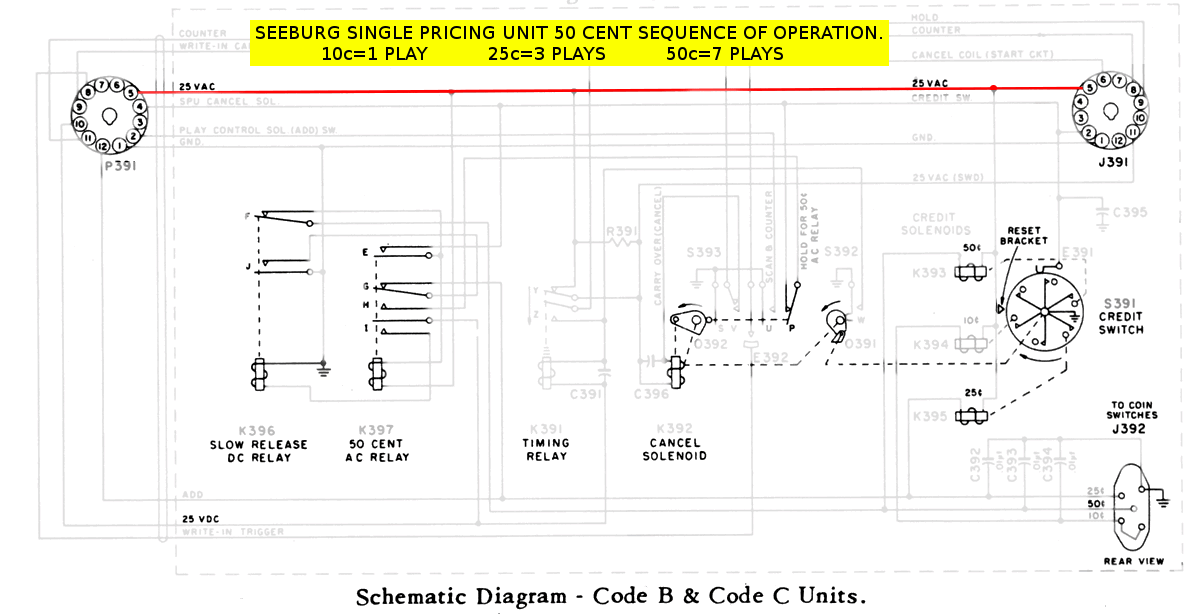

I had to rebuild my single price unit and it became necessary for me to understand how 7 plays for 50 cents is accomplished.
I made this visual for future reference.
It is NOT designed to replace the information obtained from the manual, but rather to expand on it.
Reading the manual will make this animation more understandable.
Here it is, if anyone can also find it useful. Sorry if it is too fast or too slow, depending on your browser and equipment. It should cycle 13 slides "forever" until you close it.
It may be helpful to right-click and save-as then view it from your file:
