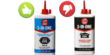

Ron has mentioned this a million times: the proper oil to use (based on his years of experience) is 3-In-One Motor Oil. I'm sure immediately every one is going to go, "Oh yeah! I have a can of that right here." and they grab for the little red can/bottle(now black). Bad mistake. You need to make sure you have the Motor Oil variety. It comes in a blue plastic bottle and has a picture of an electric motor on the front. Maybe this picture will help you keep things straight in your head when you're at the hardware store:
3-In-One Motor Oil will most likely handle 95% of jukebox lubrication requirements. There are some greases that are required and I will let Ron go into detail on those. Maybe we should come up with an acronym for 3-In-One: TIOMO. If Rachael Ray can have EVOO, then I think TIOMO is fair game, no?

I can only add that 3inOne motor oil is available, under different brand names as SAE 20 wt. ND oil, in quart bottles, at GOOD auto-parts stores--as for grease, it has been my (sad) findings that most of the time, one must use the exact same type as was used previously, or it will soon turn to glue, Or, totally remove any old stuff before applying any. I use a graphite based grease--only. Ron Rich

I've been using the 3n1 oil in the red can for my Seeburg AY160 for the last year or so.
I now understand that is bad and need to switch. Exactly why is it bad, and I am wondering what damage I have done. Do I need to check and/or repair anything for its use?
