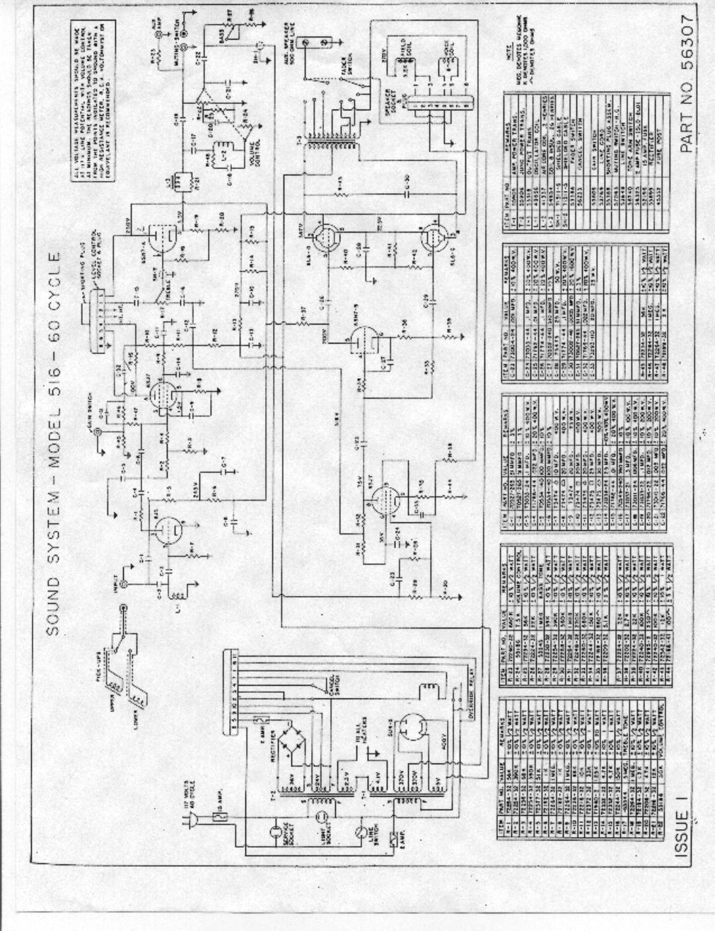

3. Is the schematic in the service manual for the 516 amp correct or are there errors contained within? I'm finding several differences that look original to the amp. I can obviously see some later repairs that appear to be wrong, but these original looking difference have me scratching my head. Should I leave alone or correct to match my schematic? For example, I have an extra wire coming off Pin 8 of the bottom (schematic wise) 6L6-G tube that connects to capacitor C-12 (in a can) on the other side of the amp. There shouldn't be such a connection, but the solder looks old and this wire is identical to the other original wiring in the amp and doesn't look like a later addition.

3, 516 Amp and 6l6. this schematic: http://www.verntisdale.com/schem/516.jpg clearly shows the typical cathode bypass capacitor from pin 8 on a 6L6.

3. The bypass cap you speak of on the schematic...are you referring to C-28? That's the one directly below the top 6L6 and is attached to ground and is shown between R-40 and R-41. If so, I have located this cap and it is also connected to pin 8 in addition to the wire going from pin 8 to C-12. So I have 2 caps connected to pin 8. Doesn't this double the capacitance? What effect does this have? Can I just disconnect the extra wire to C-12 or will bad things happen?
I have to confess, this is only the second electrical schematic I've ever read (the other being for my Pioneer SX-1250) and I have to say, it's easier for me to figure out what's going on in my Pioneer. I understand all the symbols and how each component works on its own, but I really have no clue what purpose each component serves in the overall circuit. I've read up on how tube amps work but I'm just not getting it. It makes no sense to me what's going on in here. If someone has the time and interest to explain this amp's schematic to me and the function of each 'stage', I would love to learn. Right now, I'm just trying to swap old caps and resistors out for new to (hopefully) improve the tone a bit and prevent future catastrophic failure. The (apparent) differences between the schematic and the actual amp aren't helping things and are giving me quite the headache. I've done well so far neither electrocuting myself on the B+ nor frying anything and I'd like to keep it that way. I have a nice Fluke DMM and it's helped out a lot but I'm definitely an amateur in using it. It took me a week to get up the nerve and confidence to take readings off live circuits in this amp. I just want this thing to sound as close to what it did back in 1952.
