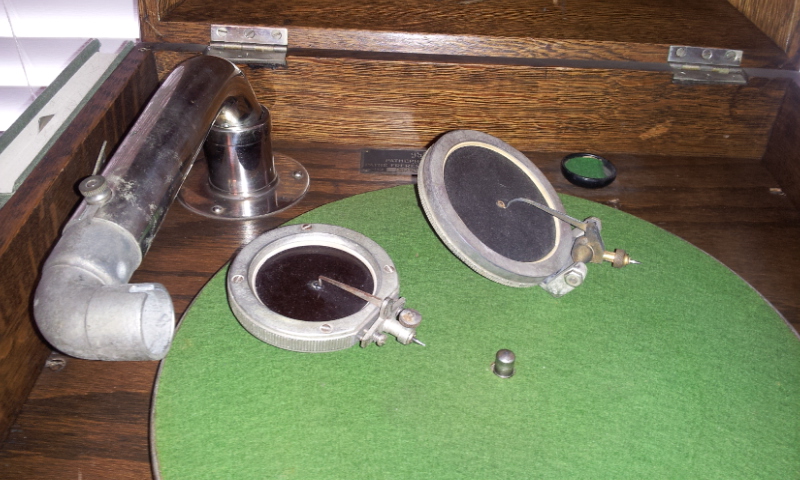

I am struggling to find information on the old Pathe phonographs and their operation. After hours of messing with the motor I have it working and the turntable is finally spinning when using the speed control on fast. However, when I assemble the producer to the arm it is so heavy that it literally stops the record from spinning. There does not appear to be an adjustment on the arm so I'm unsure if a part is missing, etc. I have a box of the original needles as well, which are not the glass type I've seen mentioned.
Can anyone provide some direction? Resources on this type of thing are hard to find.....

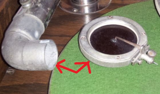

Thank you, Joe. I have two producers. One is larger and looks like the first video in your message. The second smaller one has the needle coming straight down from the producer with no slant like the big one. The arm also appears to have an extension that is curved that holds the producer sideways. If I take the extension off it appears to hold the producer facing me like shown in your first youtube link.
After reading your explanation I'm assuming they had this so they could play both types of records. Either way I use it, it sounds like I must have the old Pathe records? Because I was trying to play it using a needle on both producers, and on a columbia record. I will try and take a picture of these later today and upload them in case it helps.
Thanks for responding...

The reproducer (AKA "sound box") with the straight downward pointing needle bar is definitely the one to use with the adapter for playing standard laterally cut 78s, such as Columbia or Victor records. The other one, used without the adapter, is for Pathe' and other vertically cut records.
