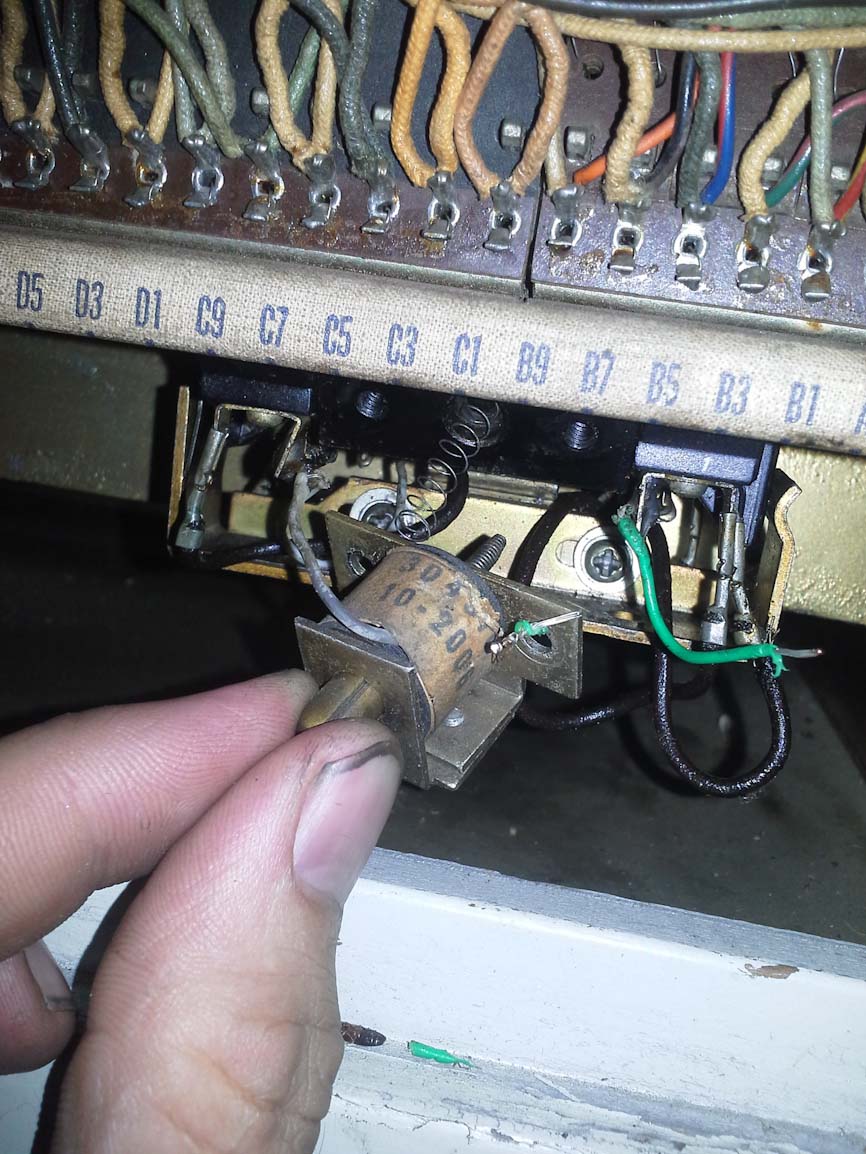

I took the back cover off. I found a broke wire on the front cancel solenoid. I soldered it back but the inside wire came out from the solenoid some. It still didn't help but I'm guessing the solenoid needs replaced.
The SC contact is on the front next to cam switch and the S contact is on the clamp arm switch correct ?

by Ron Rich » Sat Oct 04, 2014 4:40 am
Just as drawn in the Service Manual--that coil wire looks "melted"--if so, S-SC timing is wrong !!
What about the other one ? Ron Rich

by lilcobrar » Sat Oct 04, 2014 10:43 pm
Ron Rich wrote:Just as drawn in the Service Manual--that coil wire looks "melted"--if so, S-SC timing is wrong !!
I can't see the other one good. I'm going to have to take it apart a little further. S contact is in a completely different spot than SC correct ? According to my manual it is. I've not even see the S contact if it is where it says it is.
