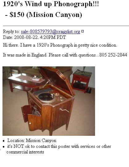

Over the years I've spotted a number of UK-made gramophones dating from the late 1920s to about the mid 1930s, that were either originally exported to the US for sale, or brought in at a later date by collectors--I'm not sure which.
These were sold under a variety of different brand names, and the cabinets are normally rather cheaply constructed, but made to look fancy. In almost all cases, they are equipped with long metal horns of the style fitted into the British made Columbia Viva-Tonal models--though not divided into two chambers; swan-neck tone arms similar to those used on the HMV 101 portables; unbranded Swiss-made sound boxes, and Garrard motors.
I used to own one that bore the name "Mastertone. " This one was constructed out of 1/4 inch plywood with a few patches of mahogany veneer placed here and there in decorative patterns, and some type of hardwood used for the corner posts, but coated with a stained lacquer finish to blend in with the rest of the cabinet. It only weighed about 20 pounds. For its size, it sounded quite good--more like a small electric table-top phonograph than an acoustic one--though it paled in comparison with the similarly sized Victor Colony (fitted with the same horn used in the Consolette).
There are a few of these listed on eBay at this time:
(Shows Typical Internal Components) http://cgi.ebay.com/Antique-English-Fur ... dZViewItem
(More typical to what I've seen, in terms of cabinet style, but this one has been gutted) http://cgi.ebay.com/CONVERTED-ENGLISH-V ... dZViewItem
At the bottom, I've posted another example--one for sale on Craigslist--though unfortunately, it's hard to see any details from the small photograph.
In any event, I'm wondering if anyone has information to share about these British made "mystery gramophones." Were they made solely for the export market, or were these also available for sale in the UK? Was one supplier responsible for these, or were they sold by a variety of small companies, but fitted with the same types of components?

The second gramophone in your thread is an "Academy". They show up for sale here in Holland very,very often. They had a wide range from portable to "de luxe" cabinets. They must have been very popular.
