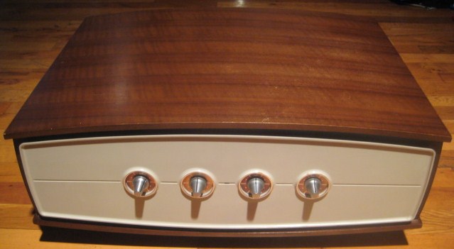

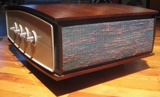

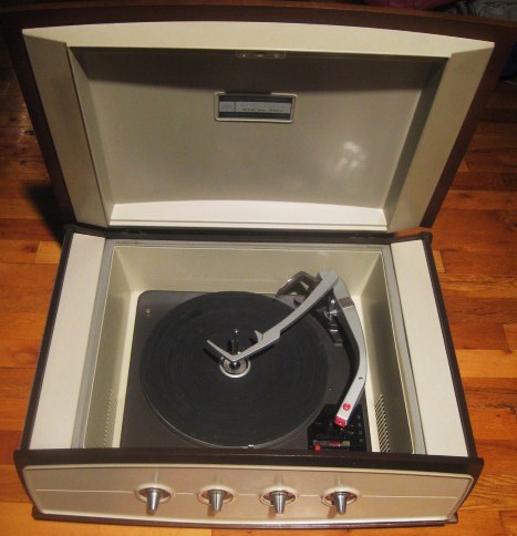

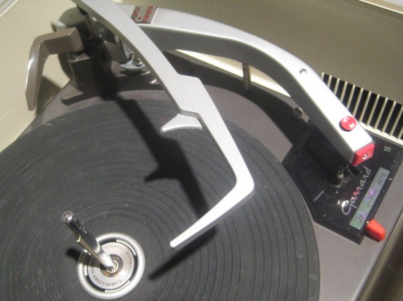

I Have This PYE Model 1006 4-Speed Phonograph..It Plays Well On Manual,But The Automatic Function Is Not Working..The Arm Will Not Swing Over!..Is This A Common Problem??..I Am Having The Same Trouble,With My Magnovox Micromatic Console...How Easy Or Difficult To Fix..Should I Bother??..They Both Play Well!

I won't say simple fix, but some parts need to be lubed while others need to be clean and dry. Parts gum up and may not retract back to their normal position. That's why a record changer my not cycle, or it may cycle repeatedly. As long as nothing is broken underneath, that may be the only type of service you may need.
Sorry for not knowing the proper names for the parts but when you want to reject a record, the pawl(?) makes contact at the base of the spindle to engage the change cycle. You have to remove the platter to see it. It's like a little blade that pushes inward and gets tripped by the nodule on the base of the platter. With the platter removed, move the tonearm toward the spindle like the end of a record. That little blade should move inward toward the spindle base to trigger the cycle. If you don't see it, it's probably gummed up/stuck.
Get someone knowledgeable to service it for you. I wasn't fortunate years ago to have the help that's available through these boards, so I used to fool around with old junk record players to see how they worked. I've dismantled turntables and put them back together just for the learning experience. The mechanical aspects came quite easily before I moved on to the electronics...either way, they're both fun! --BB
