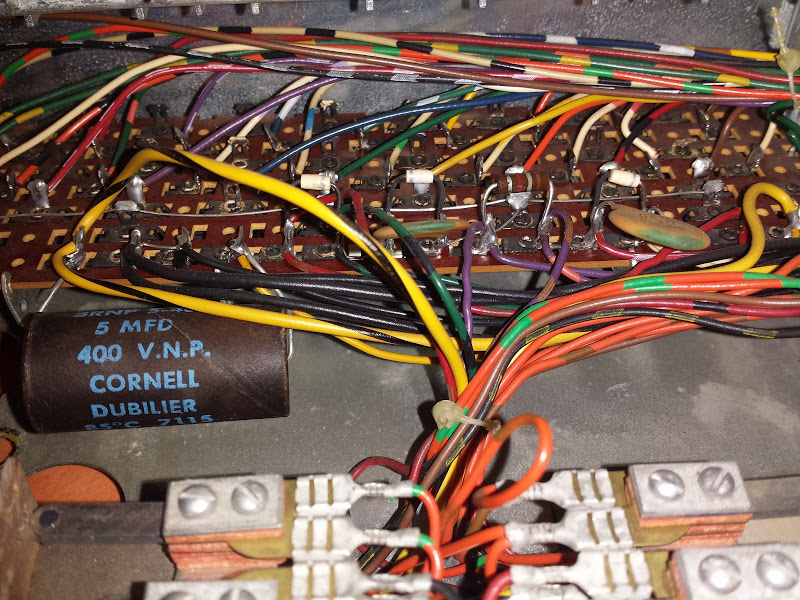

Should other caps (specifically these pictured) be replaced? Should I worry about it? There are three there - the big one is for helping to arrest sparks when the coil is cut on and off by the relays. (The other two I'm not 100% sure where they are in the circuit..)
Re: The jukebox gods hate me... (Rowe MM-6 Rebuild)
by Rob-NYC » Sun Jun 28, 2015 2:24 am
One of the relays in the keyboard determines the duration of the punch. It is an electrolytic though I can't remember what the value is. For home use, if the selection system works it is not imperative that the caps be replaced. If this were a commercial restoration or for sale, I'd replace them. I believe that model still had a clear cover over the relays in the KBD.

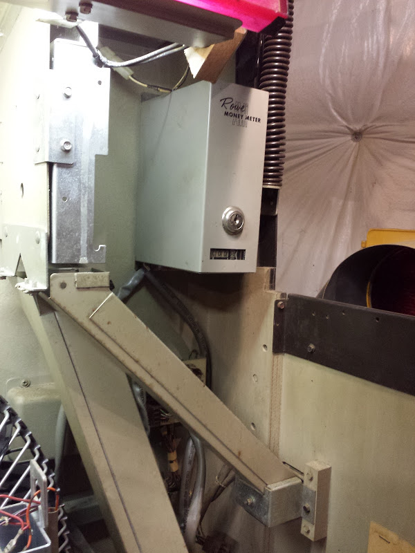

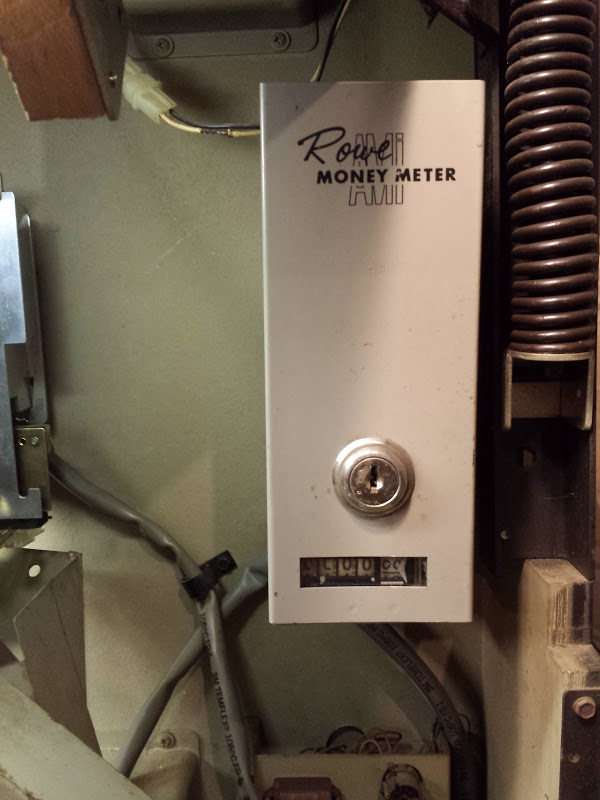

Money meter is installed. Out of the possible locations, I liked it here the best:
I reset it back to $0, and it's connected up waiting for me to close the lid and start putting money in. (Ignore the stop light in the background.)

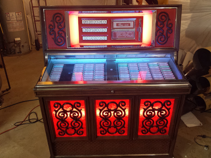

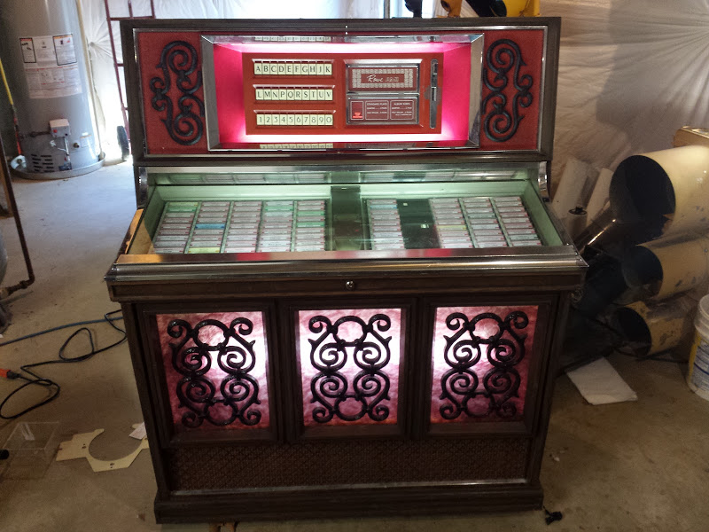

I know many of you probably will NOT like it. However, it's my juke, and I don't care. :mrgreen: Seriously, I have a thing against UV light and florescent tubes - I've lost a lot of plastics and art to CFLs and other florescent tubes in various machines and such, and I could tell that things on this have faded/discolored considerably already. (Not visible in the picture, but the red plastic around the selector? It's lighter - faded - on the top and bottom.)
Since the previous owner gheppeto'd (..did I spell that right?) the lights on the juke already, and required a complete rewiring if I wanted to get it back to factory (somehow he wired one starter into two bulbs. No friggin' clue how it worked and didn't burn up / blow up), I decided to go a different route.
The MM6 I had back in the late 80's, early 90's, my father put in some colored sleeves around the tubes, to 'snazz it up'. His words. I never knew this wasn't part of the original design, and liked how it looked. Even to this day. So, I followed suit, but used newer lighting -
Note that digital cameras don't like the monochromacity of LEDs.. The selector lights are NOT that bright, and the fade off at the corners is not noticable in person at all. Uses under 40% of the power the tubes used, and no UV light to discolor. Took only a weekend for most of it - the longest time consuming was figuring out HOW to mount the lights.
