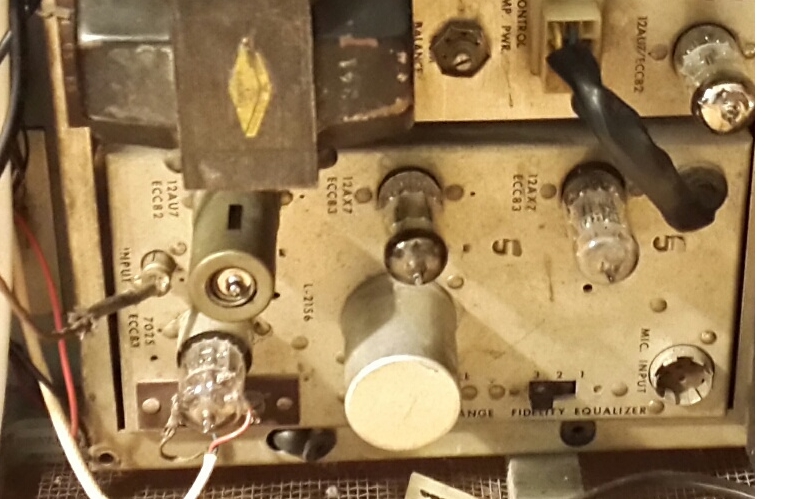

BTW: i meant to ask about what looks like a tube missing from that amp. That may be the AGC (automatic volume leveler) tube. If so you may be getting a lot of distortion from loud records as these circuits have a large amount of excess gain to allow the agc to bring up quiet records to the same relative level as loud ones.

yes it was an old pic missing one tube
the other 'black hole' you see is mic inlet (so it says)
i think its quite unique amp as it also has fidelity equalizer, which is quite nice
it might be that its a french manufactured AMI (EDEN-AMI) so it has different Amp
eitan

Eitan, other than the size of the transformers that amp appears as the American version.
I noticed on the earlier pic that the pickup seemed to be plugged into the auxiliary amp plug and not into the 'phono" input. Was that how you received it? i ask because there is no way the original magnetic would work properly connected that way.

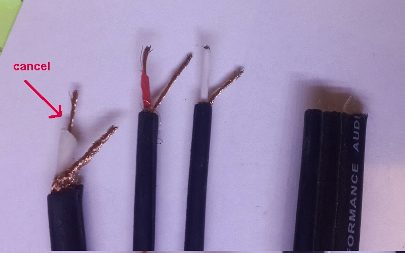

Ron, Rob
can you look at this cable?
i couldn't get too much choice here
none would include separate shielded couple, so:
this combo (for cameras they say) includes 2 separate shielded with 1 wire inside + extra one wire shielded
so, do you see any problem connecting the two similar ones and joining their shielding (as potentiometer cables)
and, using the other shielded single as cancel control ? (i.e. using its shield and its wire as to activate the cancel)

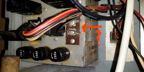

Also, where are the cancel terminals located, is this the terminal in the pics? near the fueses ?

by Rob-NYC » Fri Mar 18, 2016 3:47 pm
Eitan, yes those cables can be used. Use the inner conductors for the signal and the shield for the chassis ground (obviously).
