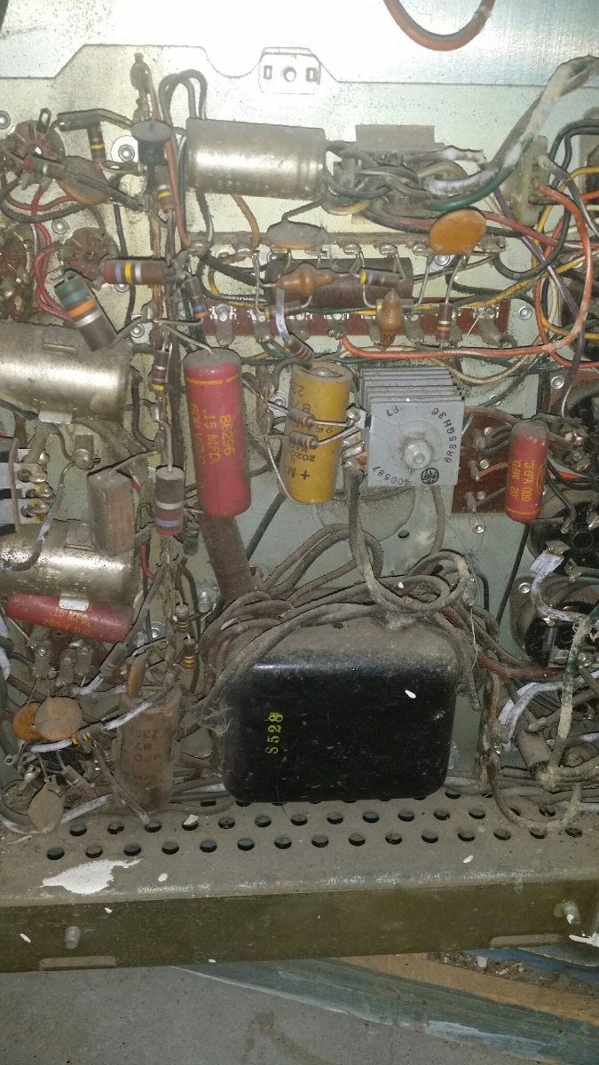

Maybe a pic will help?? My question is just - should I replace the cap's here as the first step in troubleshooting an intermittent selection issue? I did notice last night that it seems to work for a bit when I first plug the unit in, but after a while (10-15 minutes), it goes back to the "scans twice, plays nothing" condition after a selection is made.

Scottabs wrote:Maybe a pic will help?? My question is just - should I replace the cap's here as the first step in troubleshooting an intermittent selection issue? I did notice last night that it seems to work for a bit when I first plug the unit in, but after a while (10-15 minutes), it goes back to the "scans twice, plays nothing" condition after a selection is made.
The date code is S528 -The last week of 1958. It has to be rebuilt. At the very least all the capacitors must be replaced and certain resistors check/replaced as well. A good wash is indicated...but you must keep water out of the transformers.
It is not a good idea to even try using equipment this old w/out proper servicing.

I took a look at those and they all appear to be fully "up". But, I am noticing a definite pattern here now. If the machine has been off for a while, it has no trouble making selections. But after about 10 minutes, it stops doing that. (Then it goes back to the scan twice condition.)
Edit - I was about to submit this and I just saw Rob's post (Thanks Rob.) I'll get a cap kit, or look for the individual caps online. (Recommendations?) Rob, are there specific resistors that you recommend that I check/replace? Yeah, I noticed it was pretty grungy back there when I took the pic, so I'll do some cleaning as well.

by Ron Rich » Sat Sep 17, 2016 6:39 pm
Hi Scott,
Rob is 150 % correct-I miss read your post somehow, and totally missed the pix--that unit must be rebuilt, prior to any further use ! BTW--the "yellow, or orange date stamp" indicates the date the production dept. received the item stamped, for use--NOT the date of production (of the assembly) ! Ron Rich

Hi Scott,
Cap kits are available from suppliers listed above--ALL resistors in them should be checked--especially the 5% tol. units--and the larger wattage two. I just rebuilt the identical unit, and found at least 10 out of spec. resistors.

Scott, here are the schematics for the read-out and Write-in:
http://s1192.photobucket.com/user/Rob-N ... ort=2&o=58 All caps must be replaced here and resistors checked. the 33 ohm is a frequent failure point..It should be replaced with a 2 watt. Ron recommends a wire wound.,
Write-in: http://s1192.photobucket.com/user/Rob-N ... ort=2&o=59 Again, all caps must go but note that the two 15mfd caps at the 0A2 regulators are common to both W-I and R-O. Also note that the .068 with the "Wi-TC" scribble is the actual Write-in capacitor.
The pulse amp module has a 5.6 meg-ohm resistor that often drifts up and a 047 cap that must be replaced. Both are right at the 12AX7 tube socket and easy to replace.
No mention of the amp has been made but...if that has not been rebuilt --it is critical that it be done as well.

When you said " the 33 ohm is a frequent failure point..It should be replaced with a 2 watt. Ron recommends a wire wound", do you mean the 36 ohm resistor?
Scott
Re: Seeburg Q100 - Scans twice, plays nothing (sometimes....)
by Rob-NYC » Mon Sep 19, 2016 8:42 pm
Scott, yep, it is the 36 ohm. I'm a lousy typissed.

by Ron Rich » Mon Sep 19, 2016 11:05 pm
Guys,
I don't recall saying to use a WW there--I use a NTE "flameproof"-1/2 resistor there-Don't think I have ever seen one I replaced fail again ? ( Yep--36 ohm ! :lol: --my ty-ping ainna no gooder !!!) Ron Rich
