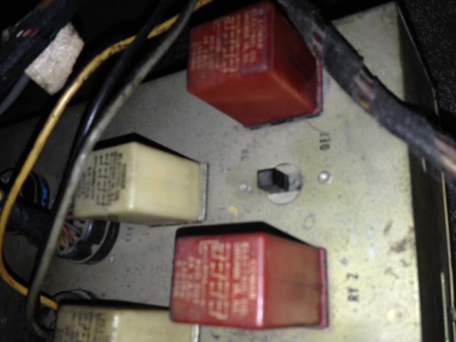

I’ve attached some pictures of the jumper wire and free play switch so I would really appreciate any advice to get this working.

2800 Jumpered Coin Mech

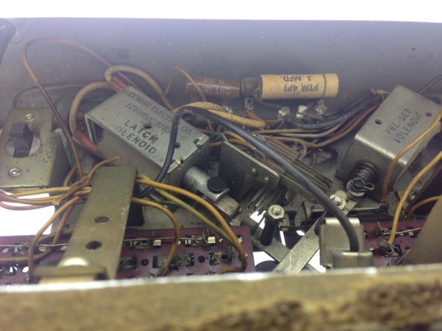

2800 Free Play switch
photo 2.JPG (86.08 KiB) Viewed 759 times

On the photo, it appears that you have a plug inserted in the coin mech socket--is this a "jumper", or do the wires go somewhere ?
On the photo of the "switch"--that's definitely NOT, a "free play switch" ! That's the (robotics) motor control switch.
If my memory is correct, the 2800 series had a "test" (free play) switch on the keyboard.

There is no Coin Mech at all. The coin slot drops directly into the chassis which is concerning. Where the Coin Mech should connect there is a jumper which is literally just a piece on the wire jammed in there.
I did locate the free play switch behind the keyboard but it had no effect (which i why i thought it where something else). What I found when poking around was I if i bumped the pre set solenoid and then the select light came on. I did it a few times and each time I pushed down the pre set solenoid I could select one song then the light went out.
So guess now I have a few more questions: Do I have a faulty solenoid that i need to replace? or the fact the pre set solenoid need to be manually set indicate another issue? What about the switch on the keyboard doing nothing? thoughts?

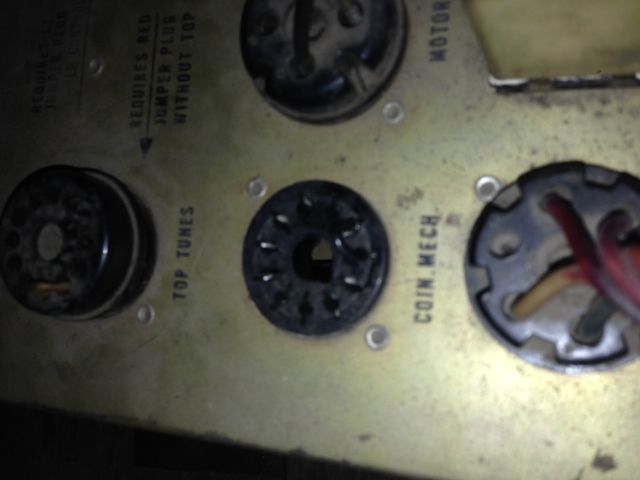

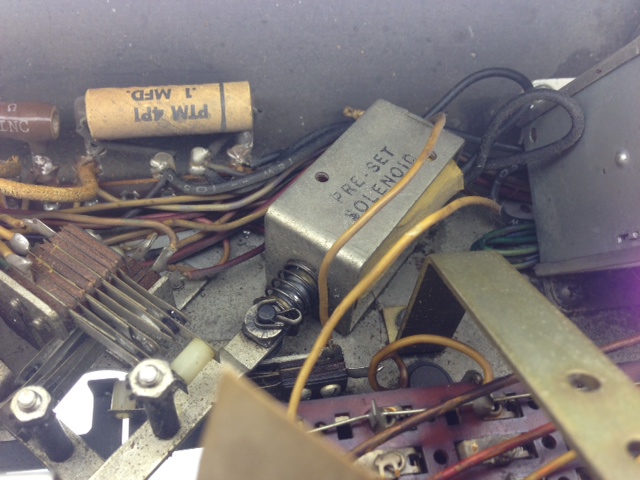

Yes I'm sure about the Pre Set Solenoid. you are correct about setting the Solenoid. as you gently press you "feel power" and then is locks in, once that happens the Selection light come on and you can do one selection. I've take a couple of pictures behind the keyboard,
Behind Keyboard, Free Play switch and Pre Set.

Solenoid close up
photo 4.JPG (122.69 KiB) Viewed 699 times

by Ron Rich » Wed Mar 12, 2014 5:53 pm
Hi Mike,
OK,your problem is in one of the contact points that are "normally closed" (with out power on), operated by the pre-set plunger. Do you know how to "service" contacts ? If so, do so, or if not, ask--
