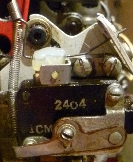

I'm a bit lost as there is only the one adjustment available for the spring length. If I reduce the spring length, the 'wire' does not pull hard enough to activate the trip switch.
I have tried to attach a photo below (not sure if this will work).
Gordon.

I failed to see the photo before--that's absolutely a spring problem, or the wrong spring.
It also appears to be "touching" the switch, which it should not--has someone attempted to bend the trip wire, or is this because of the way it is sitting on the wire ? (One should never attempt to "bend" this wire--it's "case hardened", but can be bent--very carefully--never needed, unless someone has done so previously).
This spring, as with ALL springs used by Seeburg, never need to be lengthened, nor shortened, as that one is--doing so changes the overall tension factor, making it impossible to adjust it correctly.
PM me, if you wish, as I have the correct (new) spring(s) in stock. Ron Rich

No, the 'wire' is brand new and has not been bent. The attached photo is of the old 'wire'.
The new 'wire' extends back a bit further and does not allow the spring to touch the switch.
The bracket that holds the 'wire' does not have any adjustment so no room to move there, I did however bend it away (a very little bit), from the housing to provide a little extra room for the nylon actuator to have a little more space to pivot as it was a bit tight.

BTW: it does appear that the whisker on yours is bent upwards.
