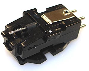

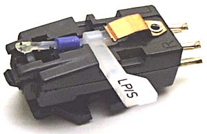

The ceramic cartridge Pfanstiehl P-132D is a good replacement. It works and sounds fine in X5. You can get it at Victory Glass, it's their part number 3744. http://www.victoryglass.com
Originally this cartridge comes with a Varco TN4 needle. If you can find a "Columbia DSN45" needle, then you might want to replace the Varco against the Columbia. The Columbia needle creates a greater dynamic sound than the Varco in my opinion (we sell the P-132D cartridge with Columbia needle).
Pfanstiehl P-132D with Columbia DSN45
Pfanstiehl P-132D with Varco TN4
