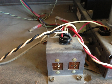

Also, does anyone know how to hook up external speakers to this using basic speaker wire? Below is a close up of the external speaker connector. Is there an adaptor that I can use?

Re: Packard Bell RPC-60 Stereo Hi-Fi Console
by MattTech » Thu Apr 04, 2013 7:03 pm
The service manual would contain all the information needed to figure out the speaker wiring arrangement.
A lot of consoles used a propriatory system for speaker hookups.
The jack panel photo you posted should be identifiable in the manual as well.
Then, suitable arrangements can be made for connecting external speakers without damaging the system.
