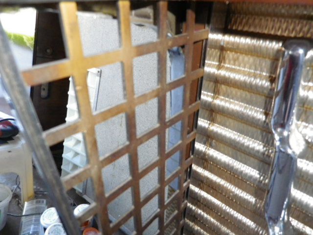

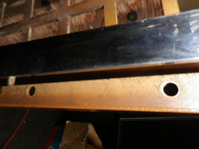

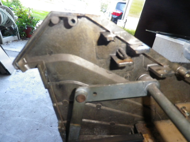

The chrome pieces are attached to the door, not the cabinet, so there could not be any connection to the casters. It almost appears to have some super adhesive holding them on(spilled drinks?). There are 4 screws that attach and hold the front chrome plate to this piece. Then there is one screw that holds this piece to a metal plate that is secured to the machine, thus holding this piece to the side. In pic 3, there is a small space between the grill and the cabinet and I can not see any screws going through the cabinet into the side piece. I have attached 3 photos in case you are able to see what I am missing if anything?

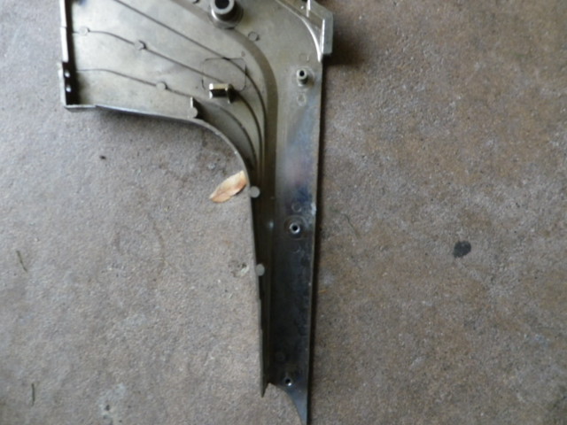

Resolved the problem by tearing door apart. Two pictures showing how it is attached. Glad I did not exert a lot of pressure prying :shock:
