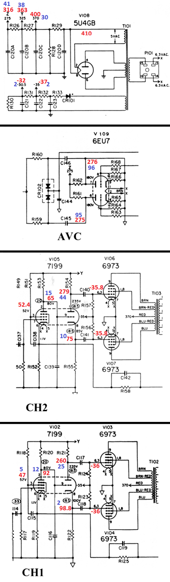

I have a Seeburg AY160 which had a lot of problems, it's been a rebuild project since July and fixing this amp will finally finish it.
Sometime last fall I had replaced all the electrolytic caps, including the ones someone else install in a "botched" repair. I did not replace any resistors because they all measured within tolerance. The amp sounded fairly well before the rebuild, except the bass and treble switches did nothing and it produced a very loud pop when the trip solenoid fired. Rebuilding the amp fixed both the issues. I had replaced both 6EU7 tubes for testing weak on my mutual conductance testers, the other tubes on the amp tested good. The amp sounds a lot better except for a couple issues.
1. There's a slight AC hum.
2. The amplifier produces its own noise. Best I can describe is a sort of scratchy and continuous white noise... Similar to the sound you get while listening to an AM radio during a lightning storm. As it goes, you make the selection and the mechanism scans. It loads the record, places the needle down and the white noise burst through and quickly fades as the music begins to play. The noise is at least as loud as the music.
I can unplug the mute connector from the amp and select a song. The noise starts as the amp's power supply comes on and remains noisy until a song begins to play, then almost disappears within 3-4 seconds. Removing the 6EU7 AVC tube does not remove the noise. I have also removed the AVC tube, and the mute plug and the audio input plug and the noise remains. The volume control effects both noise and audio signal.
I have removed both the controller and amp chassis from the jukebox and have them joined on my bench for testing. I have done some voltage readings, mainly where they are posted on the schematic. Some measurements are very close to the ones posted on the schematic while some are way off, such as the plate voltages on the AVC tube.
I was wondering if anyone have had this strange noise problem before, if it may be something common (or not). These are the voltages in question. Red figures are my measured value and Blue figures are the difference posted on the schematic. It is measured on the bench... Both the mute and audio input plugs are not inserted.
The noise has not occurred while it is on my bench.

Steve, I've had only limited dealings with those later tube amps but from the schematic I can see a few possibilities
Beginning with the HFMA-2 the squelch voltage is applied from the 25vac source in the mech via a resistor. With no mute plug there is no squelch and no derived AGC voltage. This leads me to consider that the diodes in that section may be the causes.
A few other considerations:
-Noisy junctions in the preamp transistors. Since they are not easily removable on these amps, you can try muting their output by grounding the grid of the 6EU7 (V101)
-Is noise present on both channels and reasonably equal in both?
-High measured voltages in these circuits are due to: Weak tubes or cathode resistors that have risen in value. Higher then normal line voltage. Looking at how the deviation increases as you get further away from the primary filter it is clear that current being drawn is declining. I don't consider this related to the noise problem.
SteveFury
Posts: 99
Location: Atlanta,Ga,USA
Re: Amplifier SHFA4 questions
by SteveFury » Fri Mar 07, 2014 7:43 pm
Thank you for the reply Rob.
The noise is coming out of both sides. I can rotate the balance pot to each extreme and definitely both channels make the crackling white noise.
That led me to believe it may be a power supply issue, and my biggest concern operating the jukebox was the low level hum, knowing the power supply has fresh caps. I was wondering if it were being overloaded somehow leading to the hum but we can see by voltages that is not the case, which lessens my worry.
I haven't used my scope in a few months and it isn't triggering for some reason... Just when I wanted to use it... figures.
The amp crackles through the speakers as it is powering up. It still has the original carbon power supply resistors so I'm going to the electronics store today to get new ones.
I did a quick look at the mechanism mute switches, and far as I can tell it just simply grounds the amp's audio signal when muted.

Ok, I have resolved the scratchy white noise issue. It was a new but bad coupling capacitor just after the plate output of the 6EU7.
I had taken some things for granted. Some of my tests were while it was still in the jukebox... namely if the noise is coming from both sides or just one. It's a bit hard to tell while in the jukebox because the speakers are so close together. I had assumed the balance control functioned like a regular stereo but that's not the case. With the balance hard over, it does not mute one side as others do. However on my bench, with a speaker at each end it was obvious only 1 channel had the noise.
I had to find a different way to trace this noise since my scope went kaput. I used a crystal earphone through a blocking capacitor. I first tested the output of the transistor pre-amp. Crystal clean. Then I found the noise at the output of the 6EU7. I disconnected the "new" coupling capacitor and temporarily replaced it with an off-value spare salvaged one found laying in a box somewhere and Walla... No more noise. I'll pick up another new cap of proper value next week.
I had also replaced all the "new" capacitors in the ~30volt power supply with another set of new ones (They are cheap). The 60hz hum reduced a bit.
The hum is not loud by any means... but you can hear it if the room is very quiet. The fact this amp is not 100% perfect bugs me so I'd like to solve this filtration problem if possible. Far as I recall, the amp made no hum until after I had replaced the HV filter caps last fall.
