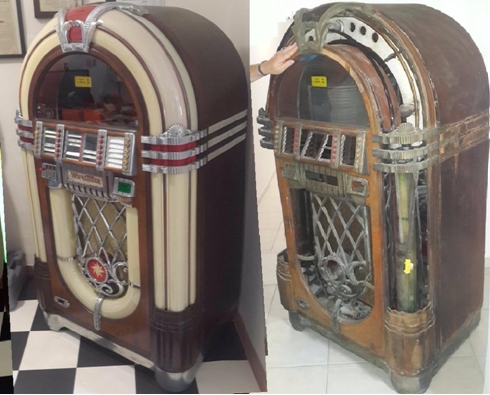

I am restoring an amazing Wurlitzer 1015 for more than a year now
by now I manage to finish all the outer parts inc bubbles and lights mechanisms.
you can see the result below - a lot of efforts were invested in this amazing machine - my 1st jukebox project.

BTW: That machine looks excellent. You've done quite a job.
