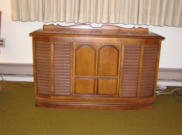

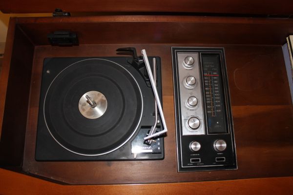

by 620film » Sun Mar 31, 2013 1:37 pm
Hi--
I recently purchased a Sylvania console, model number SC234K. Currently, I am using it to listen to the radio, and to a cd player connected to the tape inputs, and I am really happy with the sound quality. The record changer inside is a Garrard 2025T, and apparently, it has "Garrarditis": the automatic functions don't work, and the tonearm only plays the first 2/3 of the record before it won't go any farther. I found repair instructions on another site, but I can't perform them, because I simply cannot remove that 4" cog inside. I did play a 78 on it, and it, too, sounds great.
While I like working on electronics (I fix fax machines/copiers at my job,) I do not wish to inflict any damage on the equipment. I simply wish to be able to play records on my new console. What do you recommend? Shall I take the whole thing in for servicing, or should I consider replacing the changer? The owner's manual does mention that Dual 1010A, 1015, and 1019 models were also offered by Sylvania-- should I consider one of these?
Thank you,
Mike

by 620film » Sun Mar 31, 2013 2:26 pm
Here are some pictures, hope it helps.
Mike
Re: Sylvania console SC234K
by MattTech » Sun Mar 31, 2013 7:39 pm
Have it serviced. - the cutout/mounting is only for a small-chassis Garrard.
Lock the tonearm in place to prevent damage.
The two changer retaining clips are easily accessed from underneath inside the console.
They get flipped vertically 90 degrees - most people don't know this, and try to pry the clips off the bolts, damaging them.
Un-plug the power molex and two audio RCA plugs, then lift it out.
It'll require a full restoration to perform properly. - it IS, over 40 years old, ya know.
