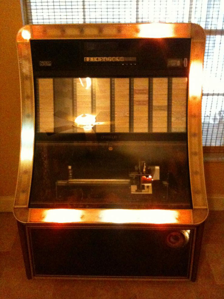

Hi, I picked up a NSM Prestige II ES160. I live in Florida in the US.
The carriage is stuck in the middle of the record tray and the turntable continues to spin. There's a loud humming sound also. If I hit the reject button on the back the sound stops but the turntable keeps spinning. When I let go of the button the hum returns. Is there a way to reset these? It seems like its stuck trying to play a record. Theres no record on the turntable. I'm not sure if it was removed. I'm including a picture of what the machine looks like.
Also the front window that you lift up to access everything won't stay up on its own. Does anyone know where I can get new struts? The ones on it must be faulty. Its very difficult to hold the window up and do anything inside the machine.
Can anyone help? Thank you

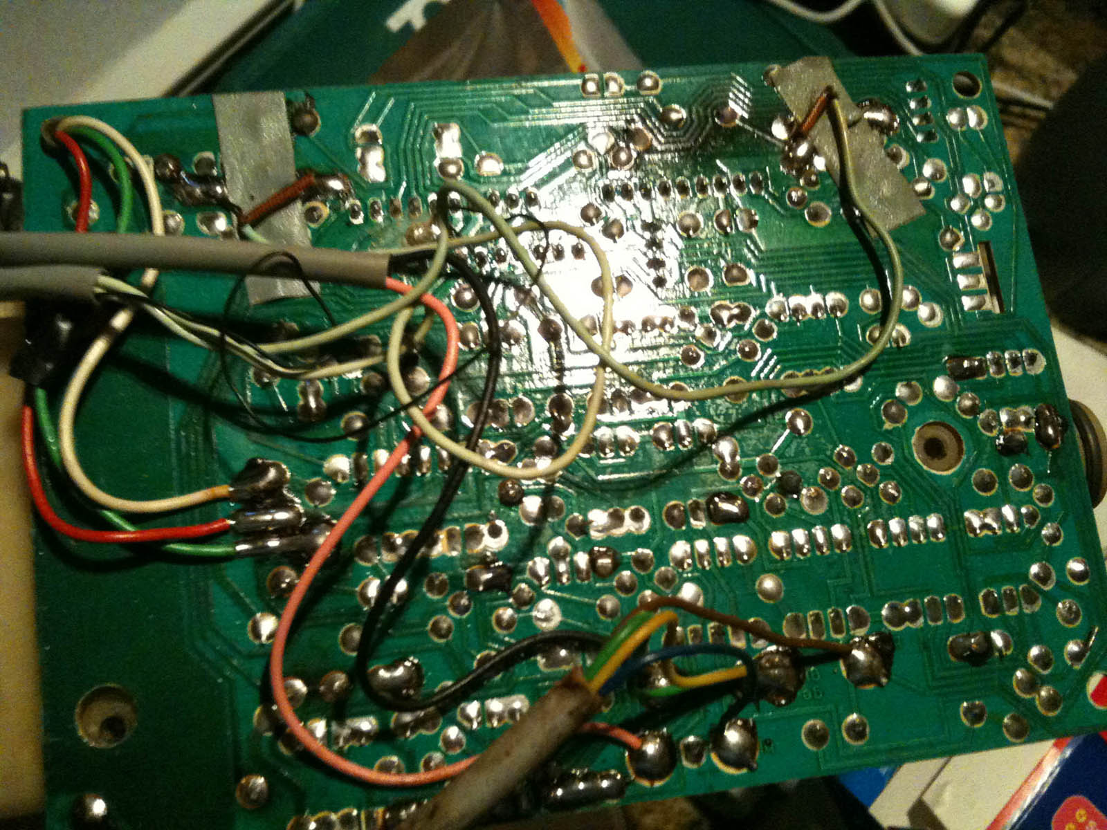

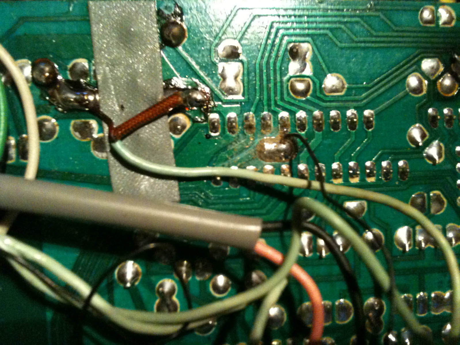

I took a look at the pcb that controls the carriage. this pic has the bottom side of the main connectors. There was a lot of corrosion especially around the small black wire thats connecting to the middle behind the main connector. There's also tape and jumpers on a couple of parts. I don't know where to start with this.

Here's a full pic of the board

Re: NSM Prestige II problem
by Ron Rich » Thu Jan 19, 2012 5:45 am
Well,
That's not "corrosion", it's simply flux, which looks bad, but causes no problems.
Sorry, I can't help further-- Ron Rich

by mb9513 » Fri Jan 20, 2012 3:58 am
from the pics i don't see anything obvious. the components on the flip side are what need to be checked out. look for any dark spots on the board near the resistors. capacitors should not look bloated, like a bad can of mushrooms. you can gently move the componants and see if any seem to move easily, that could mean cold solder joints. i would still check all mechanical parts and clean clean clean. i looked in the top part of the forum for where you can get parts and manuals. Victory glass has them. there are also several sites listed in Europe where nsm is more popular. also look on google under NSM prestige 2. i found places that specialize in nsm service.. also there is one now on ebay. the description notes a tech in Nashville. hope this helps. Mark
