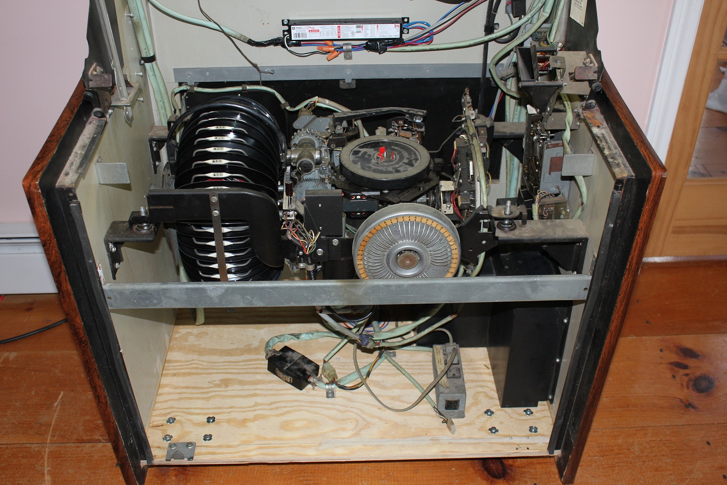

Hi all found this forum the other day and had to join. My father-in-law bought the JukeBox in the late 70's for a chinese restaurant he bought. It folded, he intern put the jukebox in his vacation house in North Conway NH. Three years ago he sold the house and his wife did not want the jukebox in her house. My wife and I snagged it. Over the past three years I have been keeping her running. Two weeks ago my wife and children were playing records, they smelt burning plastic, ran to the box and shut it off.
This is what it looked like when she broke. As you can see the arm was stuck in the middle. Also the floor board is shot so I have always wanted to replace it, now is time.

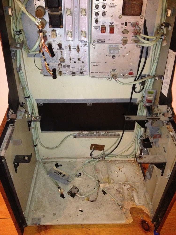

After I took out the mechanism out, removed the top and cut the floor out.

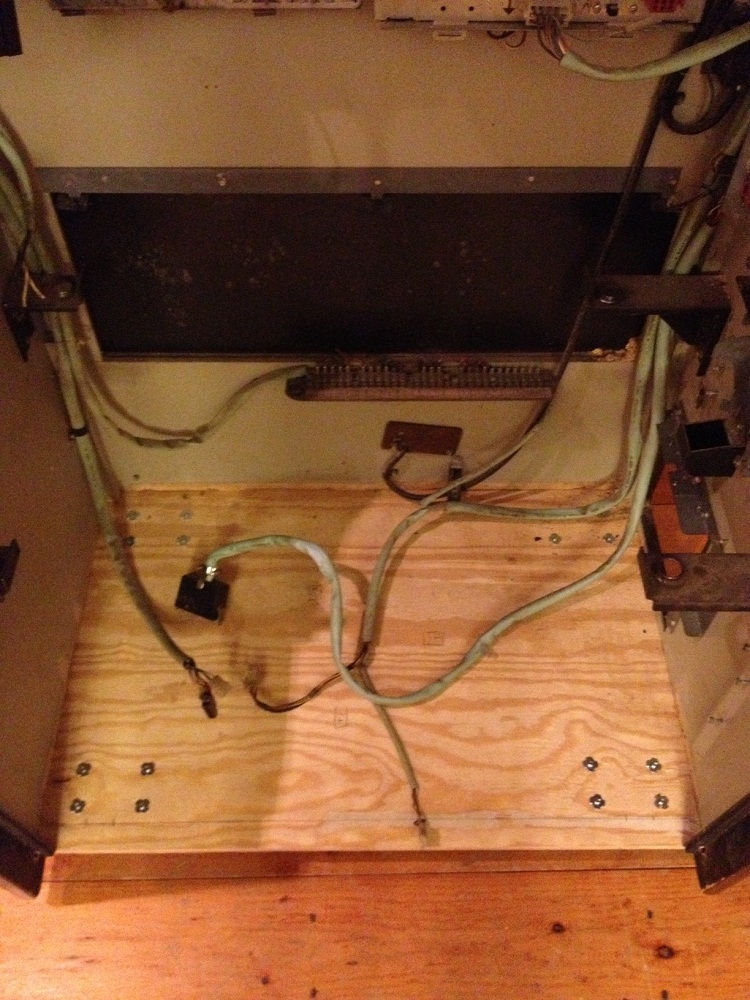

Here is the new floor, I was even impressed.

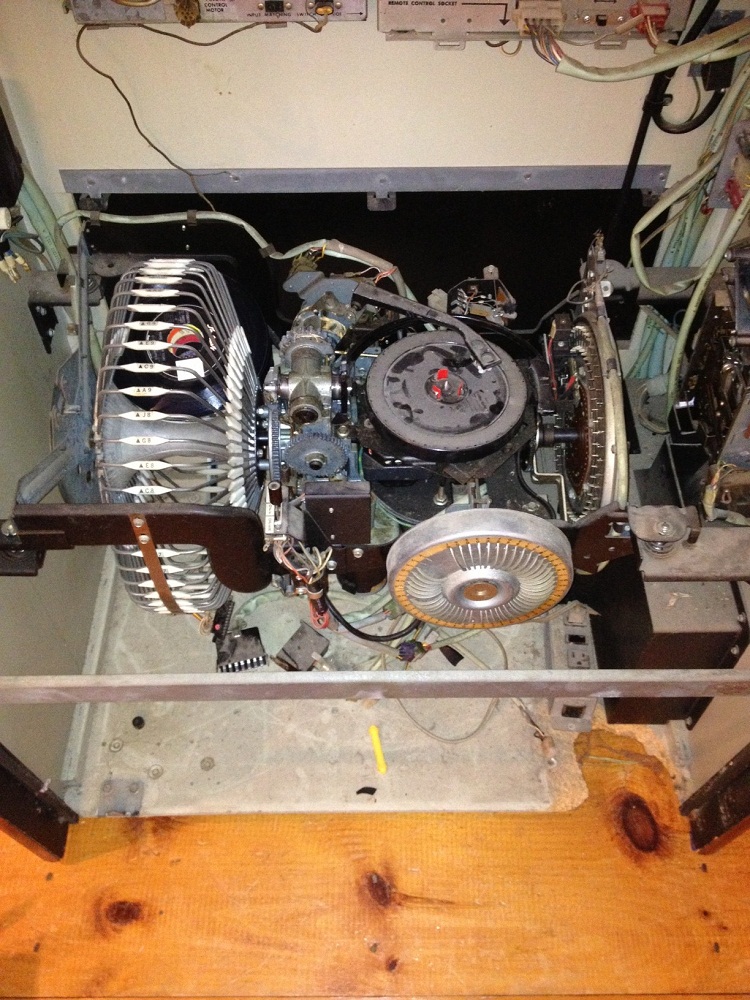

Then I got the mechanism back in, all cables connected and I even pulled all three ballasts and put one in that handles all three bulbs. I replaced a fuse and turned it on and jammed again. I played with the motors, moved the arm to the center and it rejected and stopped.
Now when I select a record the write-in selects it and thats it. All fuses are fine and when I push the select switch from operate to scan it rolls through. I have been looking throught the service manual and trying to figure it out. So basically it makes through step 12 and has an issue with step 13.

The reason I mentioned it, is because the first picture shows the machine with the pick up arm stopped in a strange position.
