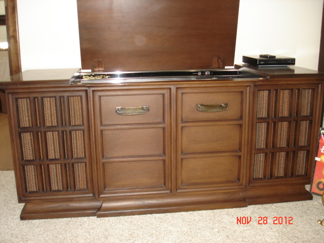

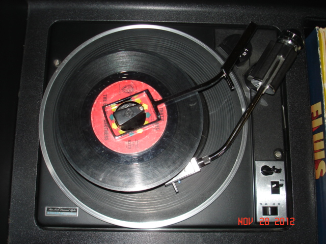

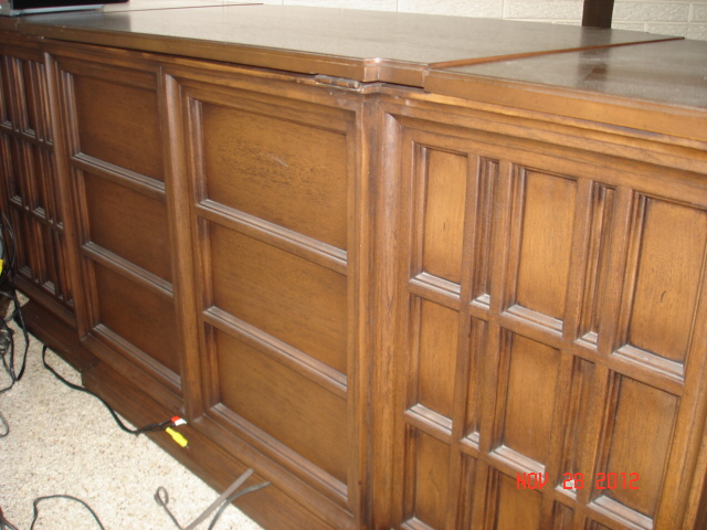

What kind of changer do I have? This is a GE 730 from the late 60s. Notice the back is finished. Were there many of that type produced? How do I adjust the player needle arm balance weight (not sure how to describe)?
Back of console
Needle arm adjust counter balance weight of arm?

Assuming the counterbalance is not a fake you would back it off until the arm suspends itself on a level plane. Recalibrate the slip ring to "0". Then turn ring and counterweight together to the proper number in grams. What the tracking force is on this unit I don't know. Hope this helps. Do not assume the stylus is good.

How do I adjust the needle arm's weight? On the back of the arm there is an adjustable (slides in and out of the arm) weight or it looks like one. The arm says "tonal 1" and the player frame has "diamond stylus" on it.

You don't--unless you have a gram gauge, and know what the correct weight should be--

Majority of these consoles were "fixed" as far as tracking pressure, and no need to go about adjusting them.
The factory knew what they were set at, to perform properly.
Us service techs do too.
If needle-hopping or mistracking/distortion is an issue, it's not a needle pressure problem.
Most likely the mechanics are bound up from age, oil turns to glue over time.
The tonearm can't track properly under these conditions.
And records get damaged because of it.
Needles also wear after decades of neglect and abuse, and records vary in condition.
All this won't be helped by messing with needle pressure. - trust me.
