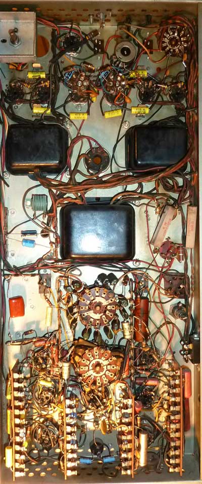

I've been busy recapping the amp with a kit I got from Bill Bickers, a Baggie stuffed to bursting with Caps! I didn't count them but there's a load of them, spent 6-7 hours yesterday working on it and I'm not done yet, I still have to do the Filters and the two boards for Channel 1, it's my first time using a Kit so it takes a little time to learn the schematic and location of all the parts, recapping an old TV will seem easy after this.
I reinstalled it after doing the first two boards for Channel 2, to make sure I wasn't screwing it up, I was happy to hear both channels working now, two still sounded a bit muddy but I was still using the shorted 6973's just in case something went pop, I also hadn't recapped the Output section and didn't want to overdrive the new tubes.
From the looks of it I think the channel might have been dead because the very first cap after the input was crumbling to bits!

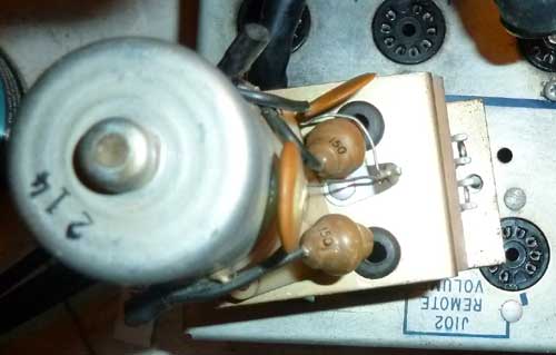

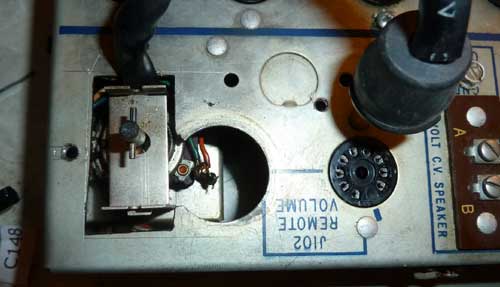

Eric H
Posts: 33
Joined: Sun Apr 17, 2011 6:44 am
Re: 6973 tubes?
by Eric H » Sun May 01, 2011 5:41 am
Thanks for the info Ron, I see now that the Motorized volume control is someones modification, the chassis was cut to accommodate it and a control with the slip clutch was installed.
From the mounting holes that were added it's apparent they must have cut away a part of the Motor mounting bracket to clear the plug for the Remote Volume Control.
I thought something was amiss when I first saw it since the holes were cattywompus.
I'm guessing this model originally used a non motorized control, a remote potentiometer that plugged in between the chassis and cable?
Anyway, it's been modded already and I got the motor and shaft so I might as well go ahead and use it. :)
By the way, what would the correct amp for this be?
Cockeyed mounting.
Posts: 8195
Re: 6973 tubes?
by Ron Rich » Sun May 01, 2011 5:54 am
Eric,
Yep--it's been "modded" ! You are correct, it has a plug in VC with wires--(BTW--check the value of that pot--the correct one is 25 k, later tube amps, that had motor provisions, used a 100k pot)
SHFA-3 would be the correct model. Ron Rich

Posts: 8195
Re: 6973 tubes?
by Ron Rich » Sun May 01, 2011 6:01 am
Eric,
Just re-read your post---
No they would have used a PRVC-1 motor on it--it mounted to the "shoulder", on the metal surrounding the pot as shown in your photo.
You have a PRVC-2 or -3 motor, in the second photo. Ron Rich

Eric H
Posts: 33
Re: 6973 tubes?
by Eric H » Sun May 01, 2011 6:14 am
I just tried to measure the resistance of the Potentiometer, I got some confusing readings, I'll try again later tonight or tomorrow when I have more time, whoever did it just clipped the lugs off the old control and soldered them to the new one.
I realize from looking around on the Web that the motor I should have (or rather the motor that went with that Volume Control) was the PRVC1, however if you look closely whoever hacked it drilled a couple of mounting holes on the chassis to mount a PRVC2, the holes line up perfectly, that's why I thought I was buying the correct one on eBay. :oops: Should have looked more closely.
