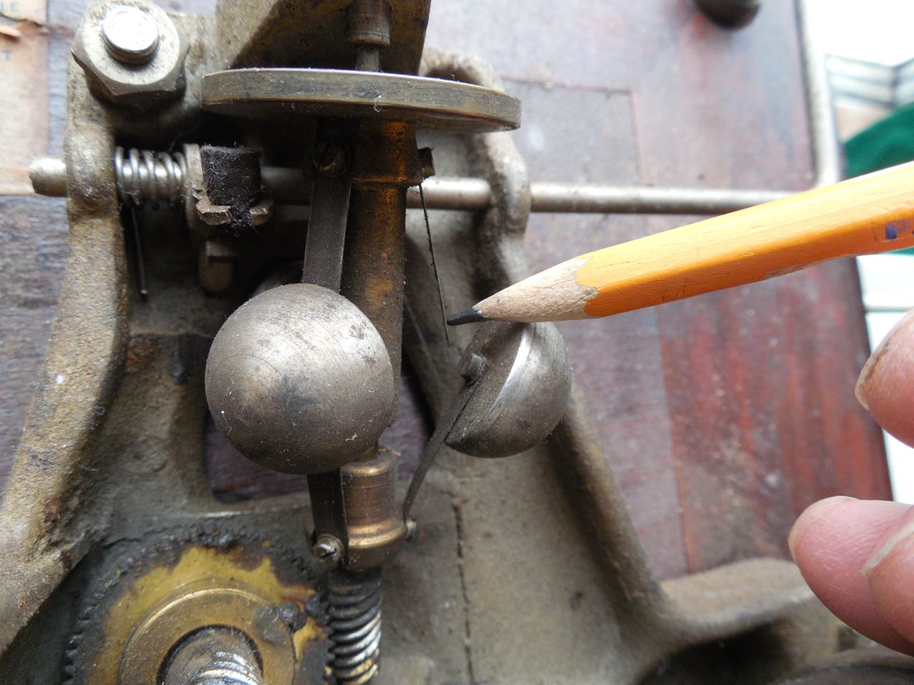

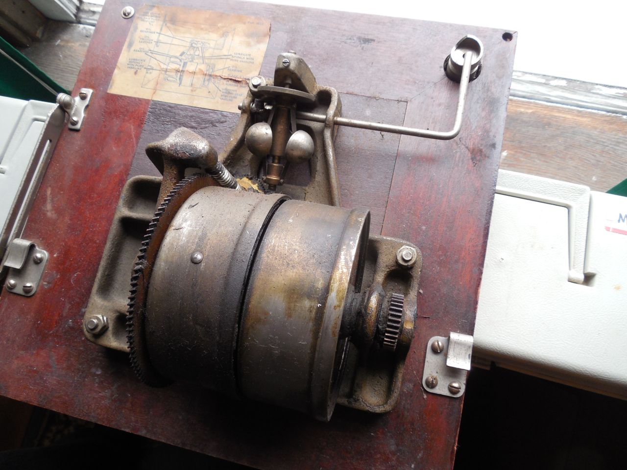

Hello,
I hope someone will recognize this spring-powered phonograph mechanism. Surely someone is looking for such a thing. It works, but has a problem: one of the governor's springs is broken where it attaches to the ball, indicated by the pencil in the photo. Please let me know what I should do with device. If I discovered it's valuable, I would painstakingly clean it up. Thanks very much!

It looks like the one on this page -- http://www.victrolarepairservice.com/motorcleaning.html -- which is dated to the mid-teens, and was originally fitted into a Victrola (enclosed horn model), possibly a VV-XI. You might want to get in touch with the shop to find out which model it's from.
Complete Victrola motors come up for sale all the time on sites such as eBay, and normally sell for $75-$200, depending on condition and rarity. (Some motors, used for outside horn models, known as "Victor Talking Machines" sell for far more.) Replacing the governor spring should be no problem, since most of the antique phonograph suppliers have them in stock, including the one linked above.
