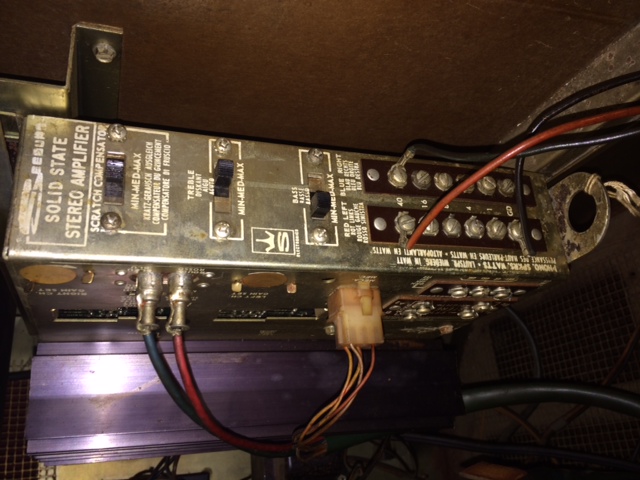

Ron Rich wrote:BTW--you did not answer me about speaker hookups ?? Ron Rich
Sorry, I thought that may have been an SHP-specific question. The attached image should give you what you need to know, I believe...
Rob: I hear ya about a total rebuild. As I mentioned when PMing with Ron about a rebuild, the problem is cost. I only paid $300 for this juke and I dont really want to pour a bunch of money into it...a full rebuild is probably going to cost me what I paid for the box to begin with :)
I know you guys would cringe, but my thinking may end up being that me doing what I can (ie. recapping for example) may be better than doing nothing...or maybe not. I donno. Not totally committed do doing anything yet, just gathering info on the possibilities.
-Bob [Walled Lk, MI]
total and complete noob with a seeburg ls 325
Re: Seeburg Amp Rebuild
by Ron Rich » Wed Jul 09, 2014 1:55 am
Rob,
Looks as if the "scratch compensator" is set above min--change it to min., to obtain more treble--
Also be sure black wire is on G, not blue wire ( sometimes they are difficult to tell apart--can't from photo)

Yeah, honestly it didn't seem like the scratch compensator does anything either...but I'll switch it anyway and see if I notice a difference. I also just put new needles on...
