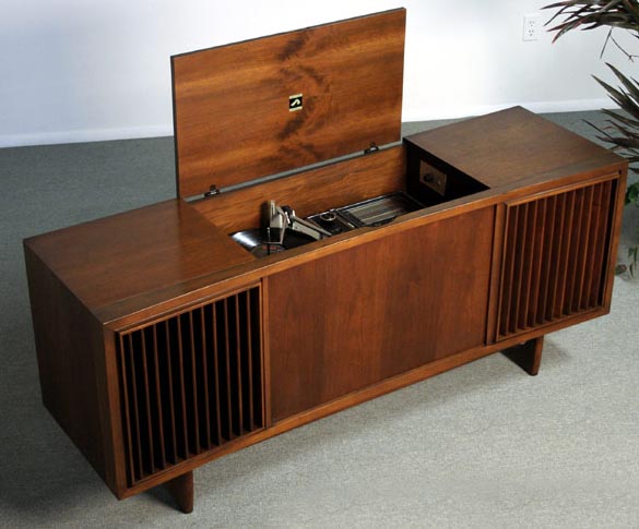

by MattTech » Sat May 21, 2016 2:16 am
This 1968 RCA console spent two weeks in my shop - including cabinet refinishing work - the people love it now.
